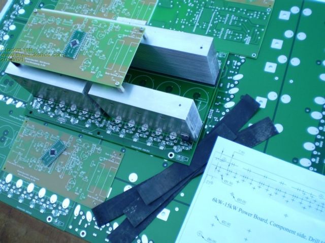

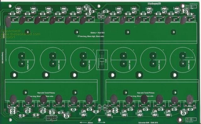

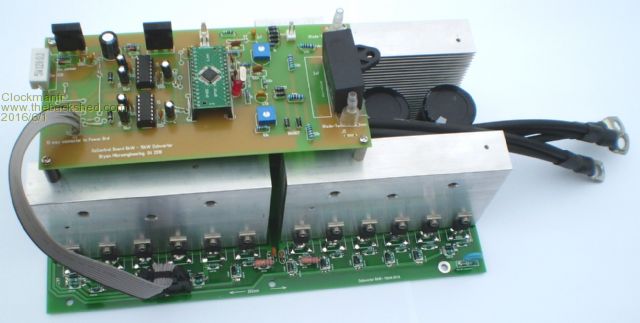

So I re-did a 'New 6-15kW Power Board' to match the 'New OzControl Board'. As you can see in the Photos we Now have are Own 6-15kW Inverter PCB Boards
The New Power board is a double sided, with double thickness of copper ie 70um, and it just fits on a sheet of A4 so its possible for home etching.

My Power Board maxed out the softwares allowable via drill holes, but it managed.

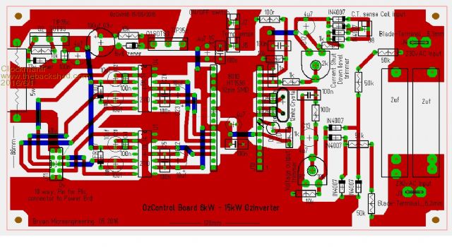

The single side boards, 'OzControl' & 'OzCooling' were a walk in the park.
So I have done all the masks for Home etch and produced 3 PCB boards. Although a double sided board is just a few cents more to remove a couple of jumpers/0r/links. But the Power board is costly.
