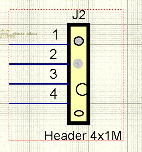

Referring to the male/female descriptor for headers, in the tips an tricks thread
Almost figured out how to add the header male/female indication. My main problem getting the "circle/disk" placed on the grid centre.
I have been unable to find the 'centre' as grab point when trying to move an object, in this case the circular object.
I have left an elliptic formed object so I can ask how do I snap to cirle, ie is there a way to ensure it is a circle I am placing.
Believe I noticed very fine incremental changes in the x and y axis when making a circle?
If running a very fine step in snap to grid, is it possible to bring the grid to the front so that one can place object 'spot on' first time?

Posted: 02:23am 06 Jun 2016
  bigmik said   Hi Plover,
Hold Ctrl down and the elipse snaps to a circle.
Once your circle is drawn just drag it to the location you want, experiment with the snap grid settings on the top (middle) tool bar.
Also if you want you can change the colour of the outline and the inner fill by clicking on the boxes just to the right of the shapes menu.. currently it is set for BLACK outline and GREY fill.
Of course if you load a part and edit it to put what ever marker you chose you can then save that part away and it will bring in your markings with it.
Kind Regards,
Mick[/quote]
Thanks. I have copied your answer in the "Tips and Tricks" for some continuation of the questions.
About changing colours, I assumed this would easy enough but have not looked at doing it yet. Was tempted to try and change the grey colour but thought I would wait until I can make a part or at least edit parts. Just in case I thought I would like a small change.

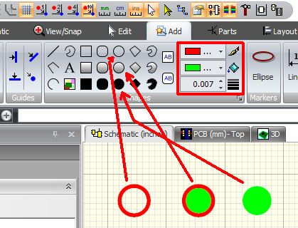

Posted: 02:31am 06 Jun 2016
Hi Plover,
This picture might help,
It shows the effect of the 3 different type ellipses,
Note that I have set the BORDER to RED and the FILL to GREEN to show the impact on each type of ellipse.
Kind Regards,
MickEdited by bigmik 2016-06-07
Posted: 02:35am 06 Jun 2016
Another Tip,
When drawing Shapes..
Pressing Ctrl whilst sizing will make X=Y, ie make a square or circle instead rectangle/ellipse
Pressing SHIFT whilst sizing will centre on the starting point/.
Pressing SHift AND Ctrl will do both centre and X=Y
Kind Regards,

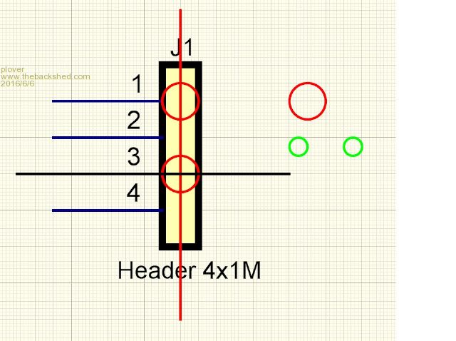

I have found tha SHIFT when sizing is what I am after, circle get centred around the line start point. I had to experiment with snap setting I think it was 5 points per grid. using the default grid, but I have got the idea. I can now mange to get the circle exactly where I want it.
Yep I also understand at least changing line colours, and I think the fill colour below. That is from your nice instructions.
I have placed a vertical red line and horizontal black line on top of the header just to get the 'proper' center point, as a helper for the time.
The circles to the right just experiments where I noticed I had coarse steps and fiddle around.
Posted: 03:31am 06 Jun 2016
GDay Plover,
Another TIP.
You can add vertical and horizontal guide lines if you prefer..
You first need to make sure that in the View/Snap key tab, under the View sub set that Guide lines are made visible. Then drag from the top ruler to add a horizontal guide line and the left hand ruler to make a vertical guide line..
Drop them where you need them.
You can also do angled ones but I have to retire for the night so I can't say off hand how you create them.
I didn't attach a screen cap as you wouldn't see the guide with TBS picture compression.. Guide them a ago they can be very useful,
