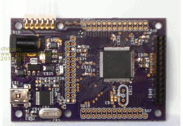

I have had a go at designing a small 100 pin pic32mx board. ( sn-5x )
It is 2 x 3 inches (50 x 75 mm), and has the power supply, usb-serial bridge
and direct usb connections. I assembled it with a pic32mx795L.
The barrel connector for power and 6 pin ICSP/pickit3 plug show the scale.
The IC pins are connected to the 4 25pin banks (apart from two pins ca. Vcap).
So far (I have not tested the direct usb connect yet) it is going ok,
polling a ds3234 rtc and running a f77 solar position calculation every second.
it is the first time I soldered a 100 pin chip, and it survived that as well !
The intent is to go to a mx470 which shares the pinout.
This has one usb and one 25pin bank in place on a purple pcb, (ed) the photo is
a bit murky though. The pads and connections for the other usb socket are on the other side.

Hi Chronic,
That looks a pretty decent board.
Is that an FTDI FT232RL chip bottom left?
My only concern is there are so many fake versions of that chip floating around that you need to be careful that you get a good one.

thanks,
the serial bridge is a mcp2200 , I had a few from a long time ago
so I used one ... I wanted a small board with all the ancilliary caps
etc and the legacy serial and also direct usb. It is really a first step
to using faster chips ... the aim is to run Colossal Cave (f77) on a
MZ EF or better (sad! :)) )
It is a mental exercise for me, it is good to do something constructive
instead of being stressed by the archipelagos of govt-paid quangos.
It is basically a vanilla connection board, I will tweak it a little yet.
Don't know if it will run the Colour MM to a console or not. Maybe I could
flog a few, (ha) !
Makes me appreciate the UBW32 design a lot - amazing but a different aimpoint.

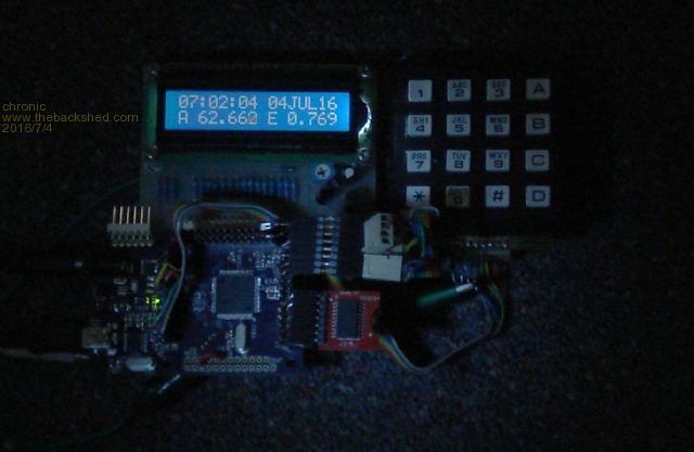

Connected up to the RTC, a small lcd and keypad with temporary cables etc,
running solar position calculation once per second. Taken at dawn (just) in
very dim midwinter light (in "shadow" of buildings, trees, clouds, etc) that the camera and browser do not handle well, sun approx. 0.7 degrees up but hidden. Azimuth 62.660 degrees from north changing to 62.662, Elevation 0.769 degrees from horizon.
Plenty of connections still available but a bit congested.
The RTC ( spi DS3234) has drifted approx. 7 seconds in 8 months, not bad at all.
