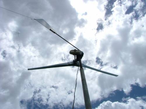

Posted: 09:35am 01 Jun 2006
I'm a big fan of the furling tail. They just seam to work so well.
This photo shows a windmill in the furled condition. The blades appear stationary as it was a fast shutter speed on the camera, but you can see the tail rope and even the drop wire are blown back. The turbine is turned out of the wind, reducing its frontal area to the wind, and not over speeding.
