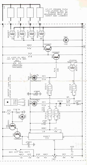

Also I have the old k220 regs, I was going to use one set at 14.8v and a second a little higher incase one fails. With the ferrite rotor how many amps/watts do I need to provide a nice load to stop overhating the coils, around 200 watts?

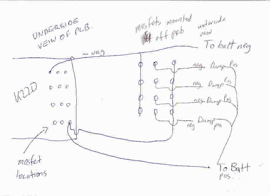

Also if you want to place the mosfets off the board is this how to wire it?

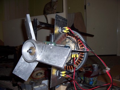

here's a pic of some dodgey welding, the big plates are aluminium where the rectifiers are mounted, I think they may be a little big and could effect furl action?
your input would be greatly appreciated

I dont have a copy of the Oatley circuit, but it looks like you could connect the MOSFETS off board like your drawing.
Dodgey welding is ok so long as there is lots of it

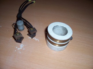

hi highlander where did you get the sliprings and brushes from and do you have some more pics of the brush holders? thanks matt

matt a neighbour gave them to me from an old mill parts box.
They are in the shed somewhere I'll have a look.
I wasn't going to use them as the wire can only handle maybe 30 amps.
The connections inside the sliprings are covered but the wire in there is probably the same size.
