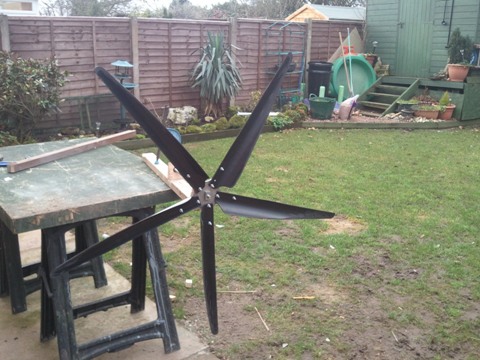

Hi i have see two plans on wooden blades the chainsaw one and one from utube
Has anyone got some dimensions or how to plan for the blades size i need i can do a 4 blade.
useing about a 600 blade then hub 600 blade is this the best size ????
What angel see one for 22 d is this the best all comments would be much appreciated
Thanks for your tome so far

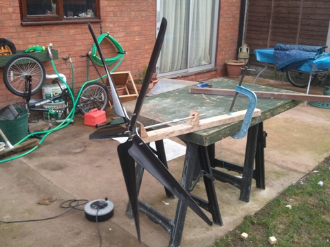

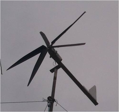

This is a pic of the ones i put up today don’t know how long they will last
Spent some time balancing them
Reddbull alan

spending extra time balancing Alan is a good thing ...it,ll let them run smoother with less stress , i,m not so sure about a 4 blade prop , they seem to suffer (like a 2 blader) from vibration when the mill yaws and will try to shake things a bit...though saying that a 2 blade seems very close in efficiency to a 3 blade
its a decent size good looking prop...maybe having a tail that furls a bit would help with the blade smashing problem ?...
you could knock up a simple constant pitch 3 blade prop using hand tools and wood ,a rough airfoil shape with a bit of taper should be fine ...trick is matching the prop to the load the generator presents ...no easy answer there , experimenting a bit might be the only way ...i couldn't find any examples of the kettler threadmill motor used as a mill , if it was an ametek youd have plenty of reference material ... but theres not as much fun in that .... Edited by niall1 2011-02-11
