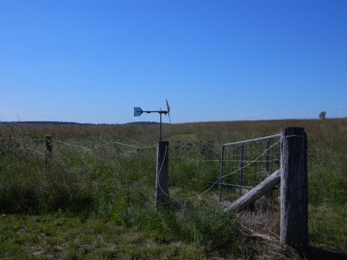

Well I have the land. Still waiting on the house and shed. Wanted to make my mark, start the ball rolling, do something symbolic of things to come. So I put up my first wind turbine at my new home.
This one has a 30mm diameter all PVC turbine ( cut from some PVC down pipe ), direct drive to a DC generator ( motor from a old printer ). Output is shunt regulated ( 8v zener ) and drives a incandescent lighting plant ( 6v torch bulb ). The tail is aluminium ( from a cut up Coke can ) and tail boom in treated timber ( pot plant stick ), and ballanced ( with a 12mm bolt zip tied to the boom ).
I expect a massive 0.5 watts from this rig.
It actually felt pretty good to see it spin up after I mounted it to the fence post.

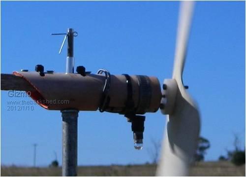

Gizmo, what did you use for your hub and connection of hub to turbine shaft?
Im building on the small scale for my first and am having probs.
My first hub disintergrated after 10 mins in brisbane winds, so I am looking for other ideas.
I saw a nice home made turbine on holidays in Forster but it too fell apart the next day I went back. Not sure if the small scale leads to more probs. I wanted a system that will fit in a car, for fishing trips (beer drinking trips).
Posted: 02:21am 10 Jan 2012
Hi Mickus
I made the hub from a little block of HDPE ( kitchen chopping board platic ). Its about 10mm thick, 15mm wide and 40mm long, with 3 holes drilled in it. The PVC blade was screwed to the outer 2 holes with self tapping screws, and the center hole is a pres fit over the little motor shaft.
I was there yesterday and very happy to see the little windmill spinning like crazy, and its little lightbulb still working.

Posted: 04:02am 10 Jan 2012
Press fit? Would that lead to slippage? My gen shaft is only 2mm Od, not much to play with
Are you able to post a close up of the hub and connection?
Im not sure I am imagining it properly and Im heading done the wrong path.
Posted: 04:19am 10 Jan 2012
We're only talking about milliwatts here, a press fit into HDPE is more than enough. The shaft on my motor was only about 2mm too. Found a photo, its actually an older hub, this one uses tiny metal nuts and bolts to secure the blade to the block instead of self tappers, but its still a press fit onto the motor shaft.
From memory the hole was about 1.5mm or so, a nice press onto the 2mm shaft. If you cant drill a hole thats a neat press fit, you can go bigger and drill another hole in from the side that intersects the shaft hole, and screw in a self tapper to hold the shaft in place. HDPE is very elastic, a brilliant material to work with.

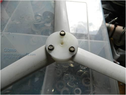

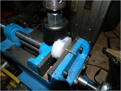

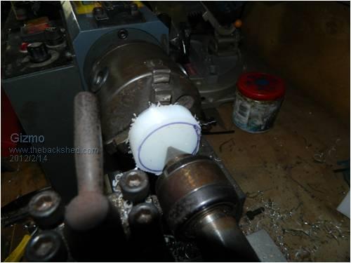

The problem is non-existent with 3 blade turbines, they have a natural balance. So I decided to make a new 3 blade turbine, just for fun. First I machined up a bit of HDPE.
Then used a hole saw to cut 3 slots at 120 degrees.

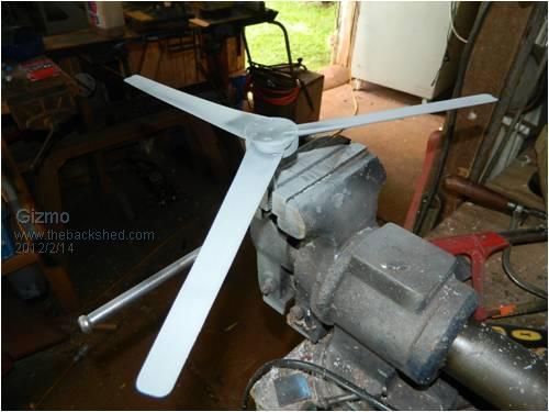

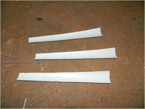

Cut 3 blades from some 40mm PVC pipe.

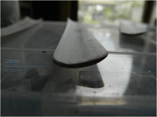

And reshaped to get a nice airfoil.
Fitted to the hub, held in place with some metal screws.
Finished turbine. Coat of paint to help block UV.
I'll put it back together tomorrow when I'm out at the block.
