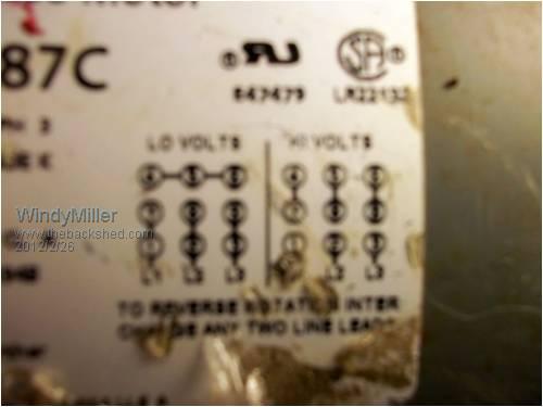

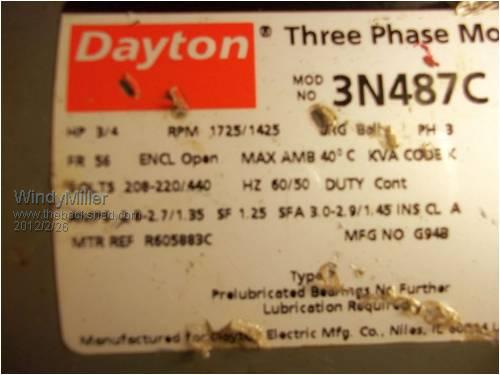

I bought a three phase AC 3/4 HP induction motor for #10 at the local flea market. The motor is a tri voltage 208, 220, 415. The motor is a 1725-1425 RPM machine rated for continous duty as a blower motor.

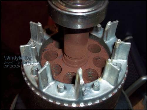

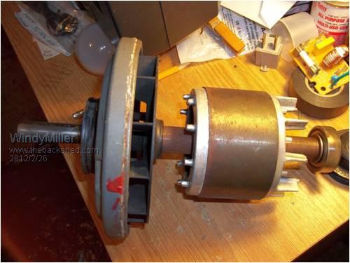

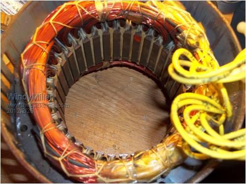

The motor I took apart to see about adding magnets when I discovered the rotor has 8 or so holes through the center. What I am wondering is if I where to put round bar magnets in a N, S, N, S arrangement two holes being N two being S all the way around which would give my 4 poles total since the machine is a 4 pole motor. If I used a gear box could I do a induction generator hybrid where the magnets helped to energize the machines capacitors at slow speed and maybe stablize the output? Anyone know why this would or would not work? The gear box I have in mind is 300 RPM in and 1800 RPM out. The winds where I live usually do not get above 5 to 10 MPH except windy days when the weather is changing. Or when we get 60 or 70 MPH gust in a thunderstorm. The problem is that without a drill press I don't have any way of drilling into the rotor like I have seen some articles talk about on here.
This is the motor below.

I personally believe my idea mentioned in the post above would work. The only real concern is with locking the rotor. Other than that I don't see why inserting the magnets in the center would not do something?

Welcome to the 4m. I culled this from your Link 1: "Unlike induction generators (IGs), the PM generators can be built with large diameters and high pole numbers."

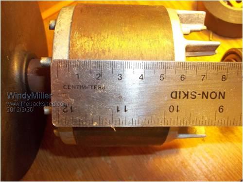

Looking at your picture, your core diameter is about 3 or 4 inches. You'll not likely create much (any) useable electricity unless you run it at higher rpms than a slow-turning windmill moves. A water-pumping mill that uses what I call a compression blade will turn relatively slowly even in a hard wind.
My hunch is, depending on your magnets' clearance to the iron core, it will lock up and be nearly impossible to start spinning even with a blade of 8 foot diameter in a low wind. With a blade that big, you'd better have a way to stop it if it gets itself into a blow!

Incase I am confusing anyone here this photo shows what I had in mind. The round bar magnets I am considering putting down the center as not to cut into the induction bars. The machine in theory would be a hybrid generator. Mainly induction with caps but also using the magnets to provide excitation and stablize the machine somewhat. I am thinking this one needs to be tested with a petrol engine to see what happens?
