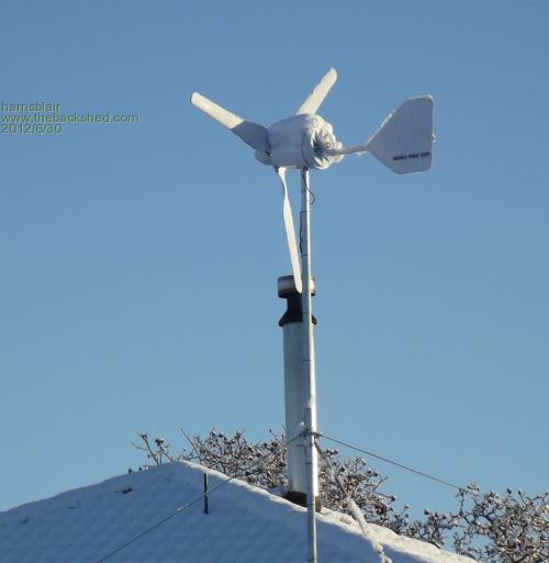

So I've just finished my new F&P wind turbine built with heaps of ideas off this website - thanks. The wind has been good but I'm not making power yet. The cheap controller I got off ebay (which is full of features) seams to be loading it up almost to a standstill. Open circuit the turbine speeds right up as expected but connected to the controller it slows up to an RPM that I know is below 12v.
So do I have a faulty controller or am I overlooking something?Edited by harrisblair 2012-06-30

It's wired in star 12v. Just like the instructions. Before I put it up I checked the volts across all the phases and was able to spin it up to 12v with my hand.
They are second hand blades 800mm long.

because I want your opinion on the RPM for these blades. This is charging my 600ah bank. Its a 20knot wind and its generating about 1amp (12v). I just expected a bit more power for this wind. The stator is wired 3x2C. Should I have done the 6x1C?
Or is this running normal?
