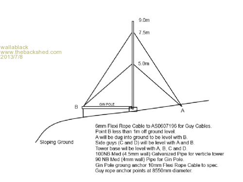

Firstly, a quick drawing of the tower...
Basically the main tower is 100Nb and the gin pole is 90NB pipe, both medium.
Rule of thumb is generally to keep all guy wire anchors level wit the base of the tower so hence the above high ground gin pole, this is ensuring "B" is level.
The first guy rope is at 5m and the top guy rope is at 7.5m.
The VERTICAL tower is constructed from two pieces of pipe, 1 @ 6.5m (standard length) and the top piece being 1 @ 2.5m.
These two pieces of pipe will be fixed together using an AS2129 slip on steel plate flanges welded to the end of the pipe, each flange has 8 x M16 bolt holes.
The guy cables are 6mm 7 Ton BS flexi rope cable (Steel, Galvanized) and to AS0607196 regulation.
So all this is up to specification and strong as an ox my main concern is the base.

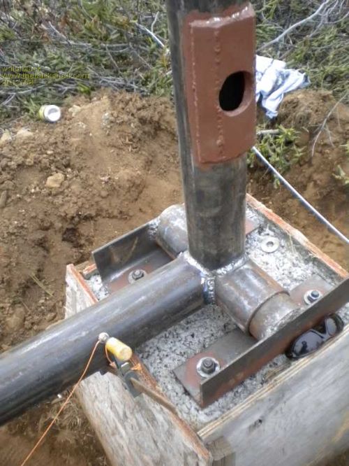

This above picture is an idea I like the most, easy to build as there is no welding involved. Now, with the gin pole not being fixed to the main tower causes an issue of the gin and the tower going away from it's 90 degree placement. At the other end of the gin pole though it is secured very well to the ground and also to two sections of the tower so it "shouldn't" go out of square. The main tower however would have to have a STOP on it to stop the tower going past 90 degrees during the standing process. And I don't see the point of having the gin pole fixed to the tower as you only use the other end of the gin pole for leverage.

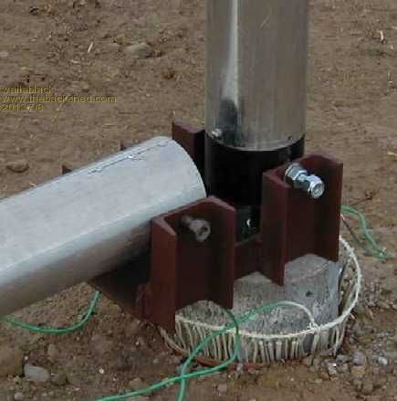

The above image is another one I semi like. Nice and solid but totally relying on bolts to keep it all together. has the advantage to be checked very often and any maintenance can be done at ground level with zero fuss. I guess it also had less part really as it is only two plates exactly the same and a pole from the ground for it to swing/mount on.

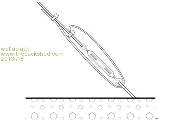

And above is the third one. I like this idea but there is a hell of a lot of fabricating and you would need very good welds. it just looks like too much to go wrong.

Looking at the first pic,
Look at the very small foundation and what is that a M12 or M16 soft bolt that does the pivoting and it looks like a bolt wleded on the inside to take the major stress of the raising of the tower.
Looking at the second pic,
Using bolts to secure a tower is asking for a failure as tower vibrations can and will loosen bolts....
Looking at the third pic
No gussets for the welding and look at the plate where the hole is cut, welds around a pipe causes stress's that can and do fail and as the pipe is welded @90 degrees it would of been easier to bring the wires out where the sun glass's are.
Just remember Murphy(that great guy) is just around the corner and ANY bodgy work will give him a reason to come around. When welding pipe towers it is OK to weld ALONG the pipe but to weld AROUND the pipe is asking for trouble down the track if that weld isn't properly supported using gussets or a clamp that goes around the pipe, then that said clamp is welded on one side ALONG the pipe and guy wires can be attached to that point.

That diagram in the first post is a bit misleading, It does say A B & C must be level but the diagram looks like A is higher up on the slope.

The first one...I don't get the whole overhang and undersized footing and there doesn't seem to be a hell of a lot of welding there either.
The second one relies wholly on that one single bolt, great idea with the two plates but the "swing mount" bit could go an upgrade.
The third pic...I am pretty sure there should be more than those 4 bolts to secure it to the footing. "Bolting" the base to the footings will be done with long "J" shaped hooks threaded on the end to form the "bolt". The bottom of the J will be almost at the bottom of the footing slab.

  Madness said   That diagram in the first post is a bit misleading, It does say A B & C must be level but the diagram looks like A is higher up on the slope.
Yeah it is a bit misleading, I just whipped up a quick drawing on paint.net to give a visual explanation rather than trying to explain it and confuse everybody.
C and D are already almost level as the ground is close and the footings will leave them spot on. I am going to dig a trench into the ground leading up to the footing on A as it is a lot higher than the base and I plan to build a small wooden or concrete "box" to keep this trench clean and keep the earth/dirt at bay.
