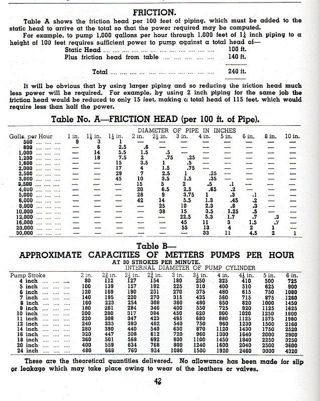

Is there a 'table' to show the pumping rate of water for a given windspeed, head etc for various models of Southern Cross Windmills?
Links would be appreciated, Thanks.
Raymond

I've never seen a pumping rate table for Southern Cross wind mills but I have seen them for other brands so I expect that a phone call or email to SX mills would get that data.
The rotation rate for a wind mill depends largely on the load on the mill and so can not be directly related to wind speed. The simplest thing to do is observe the mill column and count the number of strokes per minute, measure the stroke length and the cubic capacity of the pump. As the pump is usually a "lift" type, the litres per stroke will be constant, so litres per minute can be calculated.

Posted: 08:52pm 02 Oct 2013
should be enough info here to get you close, you need to know the stroke length that the pump rod travels as a starting point.
30 strokes a minute is no far off, most windmill have the furling set at the factory around that speed or a little faster.
edit: obviously non return valves, accumulators, and getting the pump as close in height to the waters surface (if you are pumping from a dam) and a well set up float and foot valve make a lot of difference to the amount of water pumped and the height and distance you can pump it.Edited by yahoo2 2013-10-04

Posted: 09:49pm 02 Oct 2013
Thanks for the table. Lots of interesting stuff there, appreciate your help
Raymond.
Posted: 03:57am 03 Oct 2013
Personally i think the table is next to useless for the mill at hand, as where do it show the crank travel or the gearing used for the data presented.
Well and fine to post data sheets but it needs to relate to the mill in use.
Its a bit like posting data for a brand of wind turbine and expecting it to cover all mills.
I worked for a water windmill company about 20 years prior to Mobi owning the same business, and the simple math still applies of pump diameter in relation to stroke length and strokes pre minute = displacement in volume/time.
Count the strokes and calculate the volume displaced.

Good to see that table, it can come in handy for someone finding this page in a search. Anyone happen to have run across another table like it over time? Can't wait to see that one too.

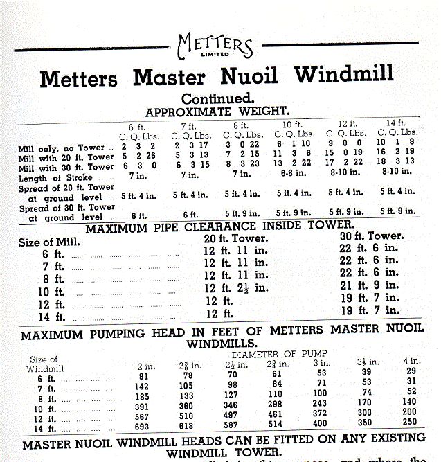

I found another table at www.windmillsareus.com.au showing spome pumping capacity for Iron Man windmill. Also some info at www.vintagewindmillpartslist.com for Z pattern SC windmills. Every bit helps to make the picture complete.
Raymond

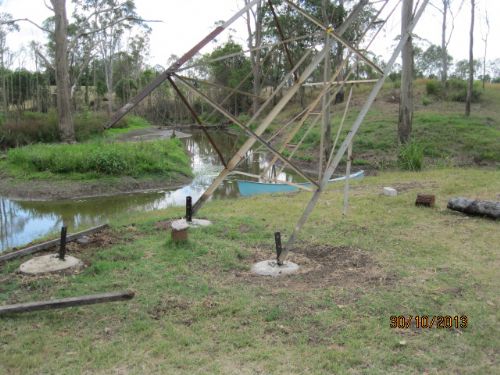

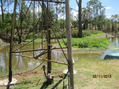

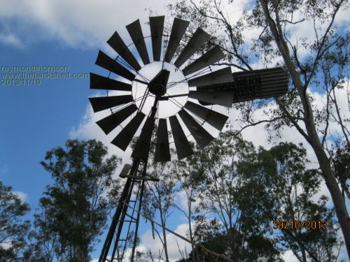

Posted: 09:02pm 18 Nov 2013
We finally made it! The windmill is up and running thanks to all who contributed information.
The raising process was a bit hairy requiring both truck and tractor in tandem because of damp grass. But the legs were exactly on target and all was well.
Climbing up to put the oil in was an interesting exercise and not to be repeated too often.
The old bore did not perform so the plumbing was re-arranged to suck from the nearby dam. We are in drought conditions and drawing from just a few cm of water but it is working well. I might get the bore attended to when the water table returns to normal but it is very old and a blast of water down it produced a heap of rust so we might stick with the dam water.
It has been a great experience and satisfied the objectives of aesthetic appearance, preservation of an Australian icon and of course the practicality of pumping water.
