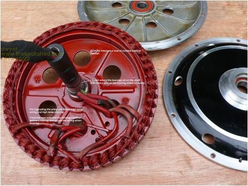

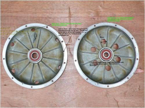

Just to let you know if you recall approx. 3 years ago about my modified Oil cool 500watt mill and still siting on the 13 metre pole has never came down for any maintenance or repair and still not one drop of oil leak Chinese 500 watts generator and did a lot of batteries charging 24 volt but not a lot of amps until last year and 3ph wires shorten out acting brake to previous from running without the load however earlier this year my daughter told me that windmill running screaming all day with two wire together instead 3 wire so l must have accidentally dislodge one of the cable when l removing the 12 x 220 amp deep cycle batteries the over the weekend anyway Oil cool mill had to dissipate the heat out of stator windings and no damage at all which l am very please with result I have notice that you drill hole to let the air might not good ideas because of wet weather so what is your suggestions? regard Ian

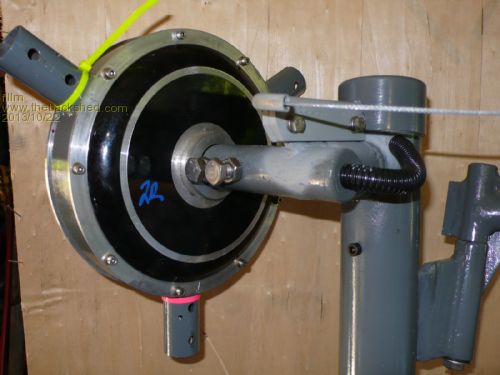

Heres a picture of the manual furl mod for the 500w mills , this works VERY WELL for positive shut down or to leave running at 1/3 power..As I have said previously , if you want to contact me on the latest mods then please do.
