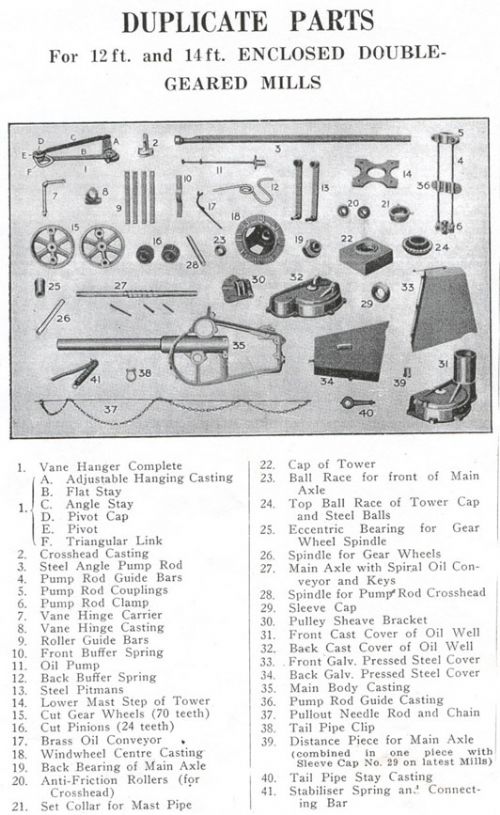

Hi all. I have just completed restoring an Alston Windmill but have been having difficulties finding a picture or description of the Control Lever. It was not connected when I found the windmill so I am unsure EXACTLY how it is connected.

Yes, the tail furling system. I have the chain but I believe that a swivel or as I think it is called 'bracket for tail pipe stay' is missing. The Needle rod goes up and attaches to the chain (internally?). I am inclined to 'jerry rig' a swivel at the bottom near the controller however as the only drawing I have shows the chain attached to the bracket it appears to go up top. There's no space except internally maybe. This is my dilemma. I want to keep it as was designed but can't find a working mill the same nor any drawings to follow. I hope you can follow me.

From what I remember,they are all a similar design. I think the pump rod is angle iron and the needle rod fits inside the angle, the bottom of the pump rod has a hole in it where it is coupled to the guide rods (the needle comes down through this hole in the pump rod and coupler) there should be a casting (bolted to the tower) that loosely holds the two guide bars and the needle rod in the middle this is the point that a cable down to the counter-weighted lever at the bottom of the mill is attached.
there should be a bar fitted to back or under the sump there is a sheave/pulley sitting over the pump shaft hole and another that lays flat towards the end of the bar close to the front buffer spring. The furling chain runs around these and clamps to the tail boom pipe.
I found a small photo of a 33 that shows the basic idea at the top. beyond the pulley laying flat at the left side of the photo is where the front buffer spring fits.
I will have a sniff around I might find a parts picture of the guide bars and coupler setup, it might help you see how it works.

Have you got the bits numbered 4,5,6 and 36 ? (top left corner) the length of the guide rods change with the stroke and amount of furling needed
the left end of the pump rod (No 3) fits into the coupler (No 5). No 36 is the bit that is fixed to the tower
the needle (37) pokes out of the pump rod (no 3) and down into the guide rod casting (no 36)
