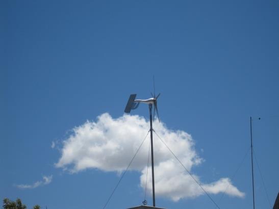

So I took that noisy GIGU down
I had seen the blades buckled into a sine wave on numerous occasions
Sounds like the jake brake on a truck, not to mention I think it is vibrating the screws out of the roofing iron.
When it makes the noise it bogs down and usually flips back end into the wind
In fact it spends most of the time flipping backwards and forwards
I compared the blades on the precision balance
One was a holden wheel nut different!
I cut up to 6 mm from the tip, this made little difference
I used a belt sander and worked the whole blade, eventually I had two the same
Then repeating the sanding I managed to get them all very close to the same weight
I fitted a random piece of aluminium to the tail
GIGU now holds steady into the wind
It still makes the noise briefly at about 30 klms wind speed but then passes through the vibration and continues to make power.
I believe this time and effort has resulted in a four times the output
