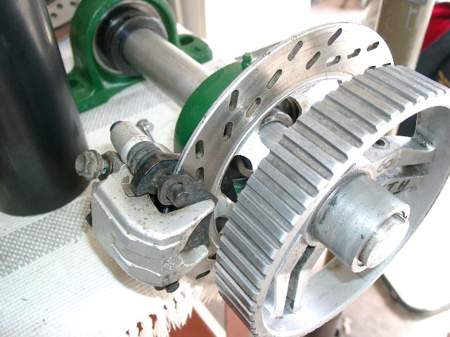

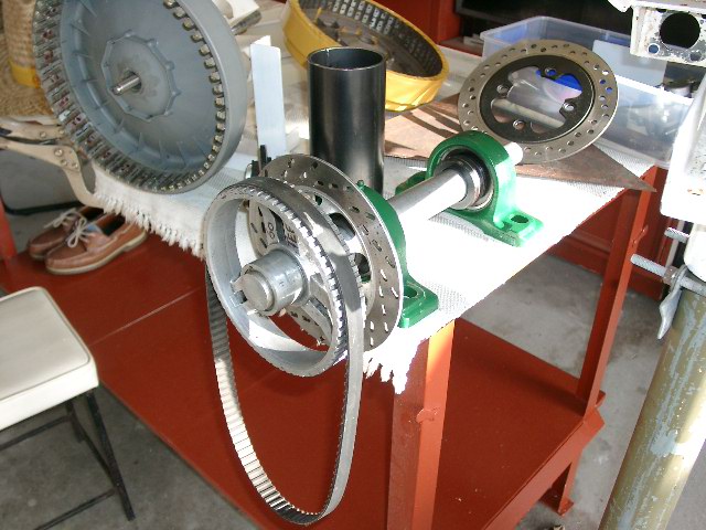

Hello Crew,, been working on a new geared timing belt drive shaft ,lately. I've fitted a motorcycle disc brake for easy shut down in storms-we get a few through here,100+ Kph .
The shaft is 32mm and will have the hub at one end for the blades and the other end will carry the disc and gear wheel,, will try a 3:1 ratio at firts,,big 13-14 foot mill should have plety of grunt to over come any friction,he hopes ..
the drive train for the F&P dual set-up will be opposite to sort of balance the weight on the tower -main yaw bearing will be 90mm pipe greased and revolving on a similar ring below ,welded to the stub pipe that will be bolted to the tower steel. I'll angle back the blades to get around 600mm clearence.

Looks good,how are you going to activate the brake?

I just found this ,, unfinished project incorporating a motor cycle disc brake .
Tried a bicycle type and it worked ok on a smalle mill
