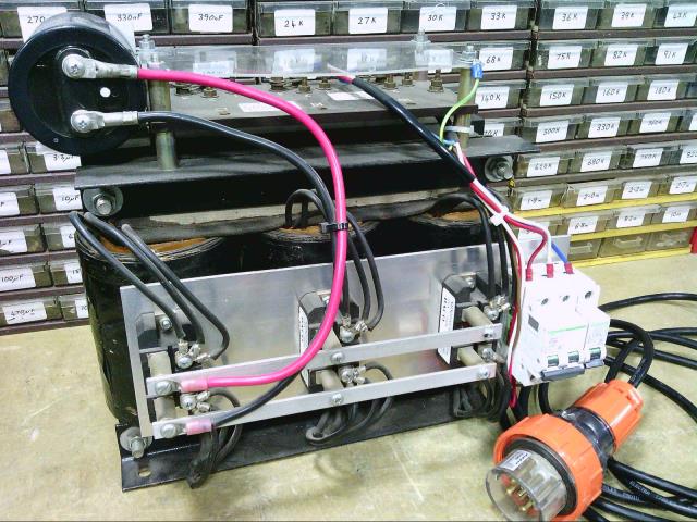

Where do you get this great idea on paper stuff ?
You are not the only person that actually builds and tests things.
This works exactly as I said it does, I even tested it with a 6KVA three phase transformer and a rectifier in both configurations.
Just to show you, I just now took a picture of the original test setup, exactly as it was back then.
Its still connected up in parallel configuration.
Somewhere here I have the diagonal shorting bars to connect it up in series.
Never tried it with a small alternator though, but if there are differences I would expect its because our sine waves may have significant distortion. I don't know what your alternator waveforms are like under load, but the mains waveform here is truly horrible.
That could skew the results significantly for both of us.
Edited by Warpspeed 2018-06-24
Cheers,  Tony.
