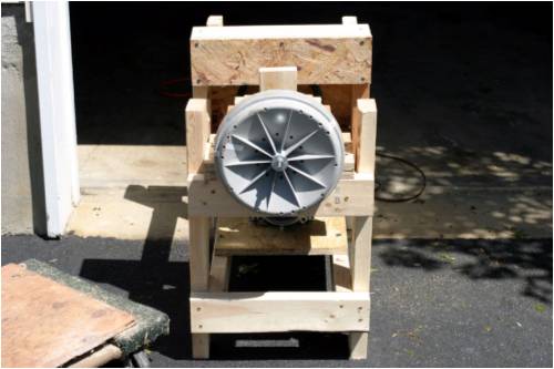

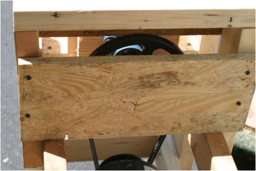

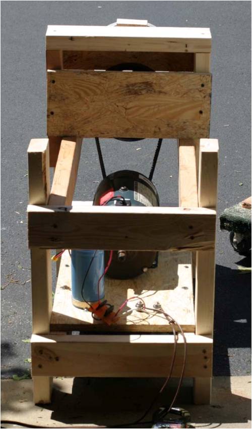

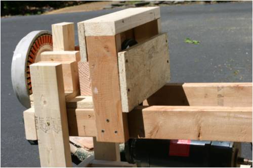

I finished by test bench and it came out really nice. I ran my generator and was able to measure rpm with a meter tied to two of the phases; and, I measured the voltage and current. I will post the graph soon, but it put out 1335w at 700rpm into 75ohms. I am keeping a journal of my work at this location
The bench is solid 2x4 and 2x8 construction. The motor is 1.5hp dc motor. The pulleys give a 2:1 gear reduction. There is a cage to trap the big flywheel in case it comes off. I used two 25A rectifiers to split the AC current so they don't overheat. They each see about 10A when I'm maxed out on my variac to the motor at 140v. Two capacitors filter the rectified voltage. I use a frequency counter on my multimeter connected to two of the phases. 28 hz equals on revolution/second. Two other multimeters measure current and voltage. Graph will follow shortly.
Here are some pictures.

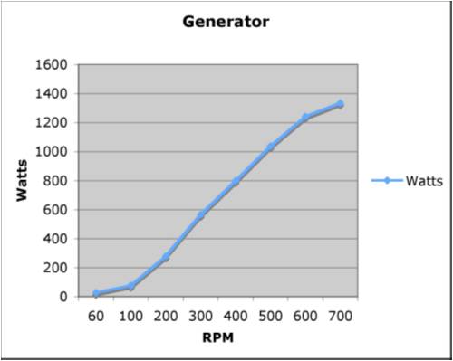

Here is the output graph
I have not noticed any distorting, yet. I designed the magnets to have the
same arc as the rotor so they bond directly onto the metal without any air
gaps. This reinforces the strength. Also, the angle chosen for the
magnets significantly reduced cogging, and, as
you can see, did not reduce the power output.
