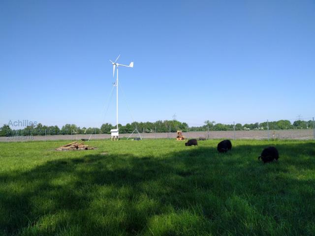

Hello everyone,
my name is Florian, I am from northern Germany and just finished building my first wind turbine system and after I had some wind a couple of days ago but no power I am trying to find the issue.
This is the turbine I bought:
https://www.alibaba.com/product-detail/HENRYD-2kw-wind-turbine-for-home_60299449838.html?spm=a2700.8443308.0.0.504b3e5fz cXKRn
I mounted it on a 9m (30 feet) tower and use this kind of grid tie inverter:
https://www.alibaba.com/product-detail/12-years-manufacturer-1000W-wind-power_60643408337.html?spm=a2700.7724838.2017115 .1.5f3d618288f1KC
It can handle 22-60V of input voltage.

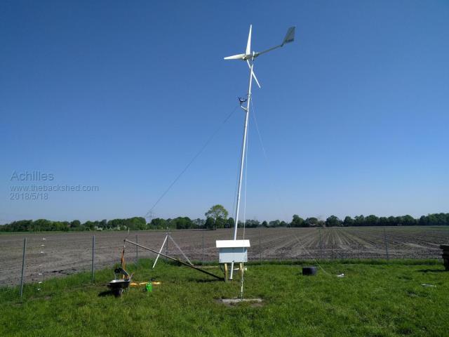

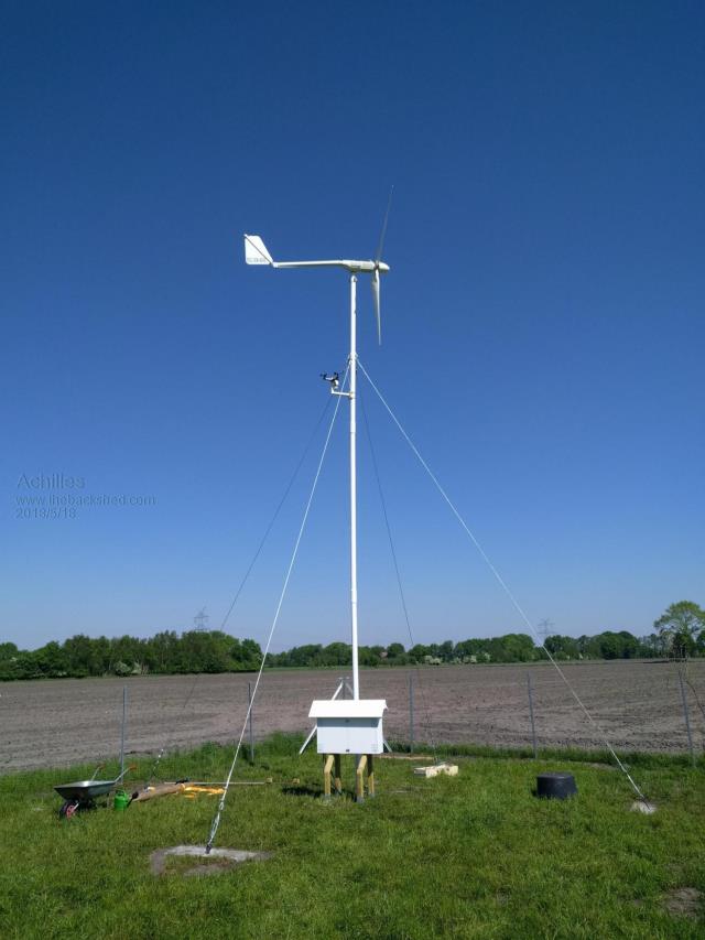

Anyway, the whole system looks like this:

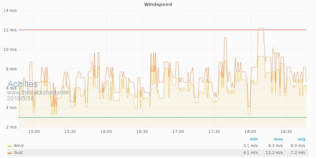

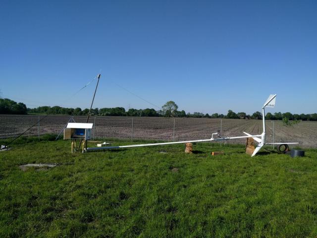

2 days ago I had some nice wind:
The problem I am faced with now is that I don't get up to speed.
Even at 7m/s wind (15.6 mph) it is only rotating at about 60-80 rpms.
At that speed I get 30 volts peak and 67W for just a few seconds.
I am assuming that the controller / inverter puts too much load on the turbine too early, thus preventing it from spinning up.
Maybe you guys have ideas on what is fishy here.

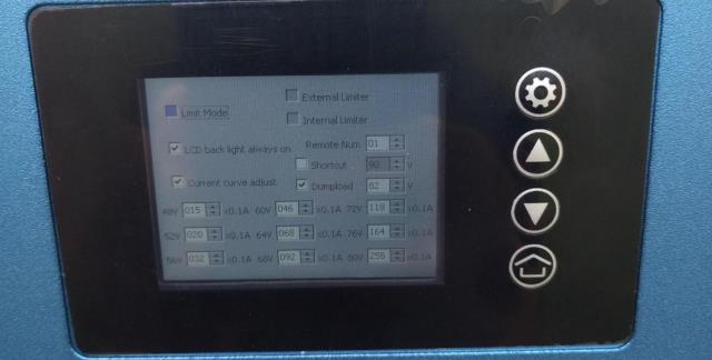

I was just outside for an hour trial and erroring those inverters.
When I only use one, set a moderate current curve and then let the generator spin up to like 30V and THEN connect the grid tie, it just works fine.
Once there is a moment with no wind and power generation stops, it doesn't go higher as 22V when the wind picks up again.
I then have to repeat the procedure of disconnecting the inverter, getting some rpms to generate about 30V and reconnect again.
Those chinese things seem to be buggy as hell.

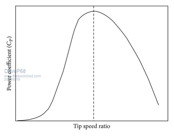

Thought it was 48V which means you are stalling the blades at cut in due the 22 - 60 inverter trying to take too much power at low RPM.
The 22 - 60 VDC 1000 W grid tie inverters try to take about 20 - 25 W of power at start up.
I suspect the 45 to 90 VDC inverter you have on order will solve the problem you have.
The blades you have look like they have a tip speed ratio of around 7 to 7.5 at a guess. This means as they start turning want to operate at over 100 RPM in light winds 2.5 - 3 m/s.
Here is a TSR graph to illustrait my point

I am also waiting to hear from the inverter manufacturer whether the current curve can be adjusted in order no not stall it at 20-22 volts.
In terms of breaks and dump loads: While planning I thought about a 48V heating element in a bucket full of water. Missouri Wind and Solar sell them quite cheap, but I have to pay shipping and customs so I haven't ordered them yet.
I do not trust those flimsy chinese "1500W" dump loads. They may survive a few high speed gusts, but certainly not a fully fledged storm.
The inverter has some kind of break built it.
I noticed, that when I let the turbine spin up to above 60v and the connect the inverter, it slows down the turbine to a halt gracefully, not like shorting the generator. This also happens when I disconnect the tie from the grid.
The shorting feature can be enabled at a certain voltage though.

These GTI inverters have a form of PWM brake/load dump function. Yes they do need a suitably sized resistive load to take "ALL of the power from the PMA" in the event the Gird goes offline (disconnected).

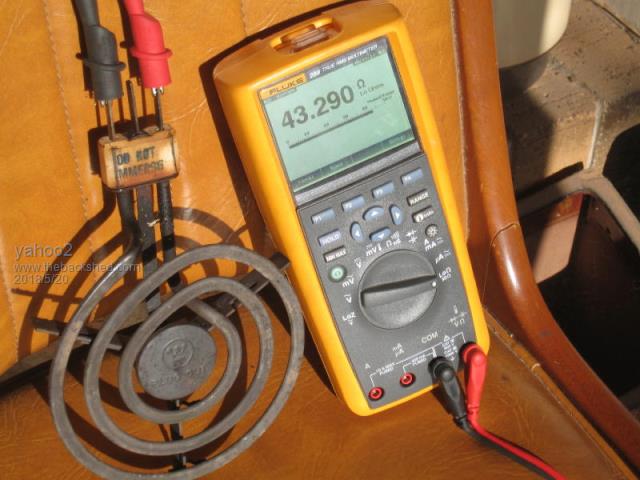

Since this is a DIY forum we would prefer to see dump loads built out of scrap.
old heaters, stove and oven elements, floodlights or even heavy gauge soft tie wire strung between insulators. You can run a fan to dissipate heat. The dump load you buy is only nichrome wire on an insulator cut to a specific length to get a certain resistance. Almost every heater element is made from nichrome wire.
You just need enough of them in parallel to handle 3200+ watts and finish up with the right resistance.
roughly 60 volts and 53 amps that's going to be 1.1-1.2 ohms
38 of these, OK maybe not, that only 90 watts each at 60 volts.
electrical laws
but you get the general idea, 3.2 kw is a lot of wind turbine to handle in a storm.
(90v x 90v) / 43 ohm is 190 watts.
16 units if it is switching on at 90 volts and 35 ampsEdited by yahoo2 2018-05-21

By the way, I performed maintenance on the turbine yesterday.
The Blades where offset by up to 2cm (.8 inches) which I corrected to be within 2mm (.08 inches). It looks like this solved my wobble during spinup problem that I completely forgot to mention.
The Squeaking was fixed by simply applying some good old WD-40 to where the shaft leads into the generator, rotated it a few times in both directions and tadaa: Silence!

  Quote  So they can now be programmed?
They can, check the picture.
But not the start current which was the issue with the low voltage version of this inverter.
Once the 45-90V model starts up it actually works all the way down to 40V which is very nice in low wind speeds.
