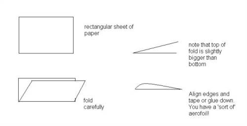

Though the Savonious looks good you might also be considering a convention horizontal design? Here is a simple scheme for making an airfoil like section from sheet material, paper in your case, sheet metal also works!
These are quite stiff and if you slide the edges of the paper along their length, just slightly, you get a curve in the airfoil! It is something you would want to practice a little before the event!

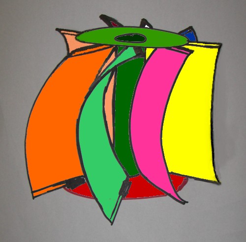

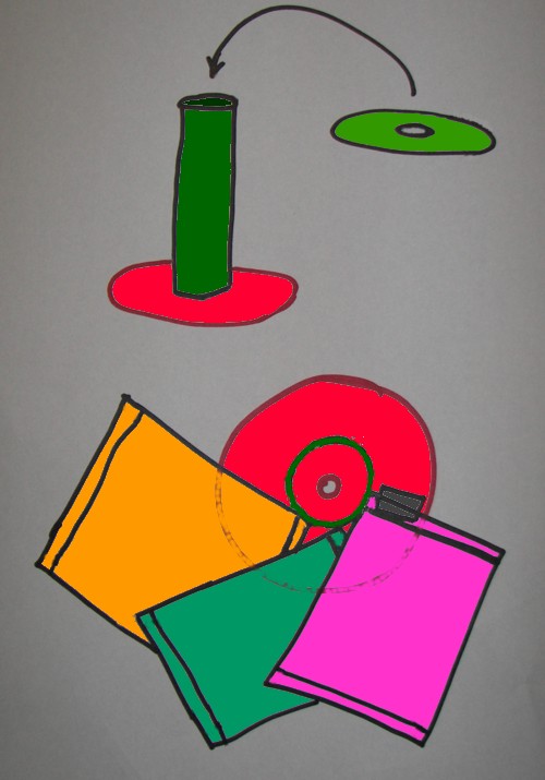

Posted: 12:51pm 22 May 2008
G'day 311fan,
Here's the design I was thinking of. Well, not really as exotic as I was thinking but I have tried to target strength and torque. I have built a few little wind generators and I've found the biggest problem is to get them started. This is nothing fancy in wind generator design, in fact it is rather crude being just a drag machine. Still, put it up against any others and see what performs better then enter with that one.
Here's the assembly:
1. Cut circle from Manila folder.
2. Roll remainder of folder into a cylinder and tape.
3. Fold a 3 x thickness stiffening hem to the top and bottom of 8 pages and secure with tape.
4. Cut the cylinder to 2/3 the height of a page and tape on the top hat.
5. Mark the CD into 8 x slices.
6. Tape on the cylinder.
7. By overlapping, Tape the 8 x pages to the 8 x marks on the CD.
8. Turn up-side-down and tape the 8 x top hems to the top hat.
9. Cross your fingers and toes.
All done.
Hints:
To make spars or rods; tightly roll a page.
To further stiffen KiwiJohns wing; add a rod inside, 1/3 back from the leading edge.
Now, lets see what damage you can do.........
Cheers Gill _Cairns, FNQ
