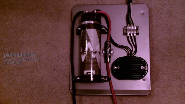

plasmahunt3r
Joined: 10/01/2016
Posts: 10
Posted: 11:37pm 19 Oct 2018
The black heat sink device is the Harley Softail Regulator. I feed in into a 2 Farad Capacitor which is parallel with the battery. The cap is there to help with surges, like when the refrigerator kicks in.
