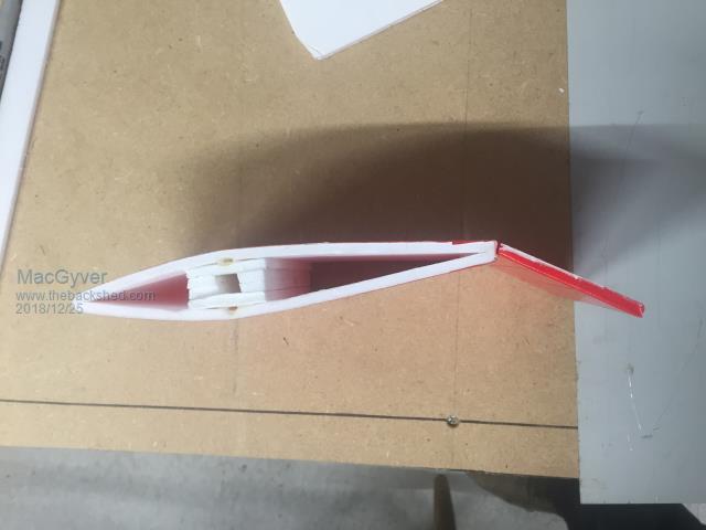

I have long been a fan of vertical axis wind turbines.
I am aware of their several drawbacks, nonetheless,
I have kept at it, trying to overcome some of the bad features.
I am intrigue by their simplicity, but they are known as “Drag“ machines.
I have addressed those megative features in a new build,
which I call the “MacGyver Cross”. I called it that because it is a blending of
several disciplines and besides, I always liked the name Southern Cross,
which is another kind of a windmill.
This new design places a set of “sailwings” set on a long moment arm
Central about a vertical axle.
I will try to put some pictures on here, but it been along time since I’ve done that,
so hide and watch, I guess.

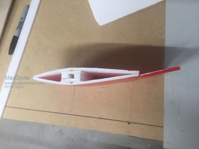

Basically, wingsails or sailwings are nothing more than a regular salil, except that
the entire wing section ( symmetrical section, by the way) pivots on the mast, so it
can be directed up-wind and there is a large Flap or elevator or rudder or whatever
you want to call it, which can bend both directions allowing an airfoil to form on either
side. For this reason, there is no stall and there is no luff. The wing is either on a tack or
On a reach and moves inboard and outboard only about 15° shifting from one side to the other.
Take a look at the small red one in the picture and you can see how moving that rudder from side
to side will create a lifting surface on the opposite side and that’s how it works.
It’s really simple and I like simple.
I am currently building a mono-pole generator, which will be used on smaller builds, which will travel faster than the monster pictured in the video, which has a center-to-wingsail moment arm of 36 inches each. It turns slowly, but has tremendous Torque.
My YouTube channel is named “Thebackshedmac”. Search for it and you will see I have posted a short video as a proof-of-concept on there, which will be followed by more videos as I build more windmills of a similar nature. I would try to put a link on here for it, but I just know I’ll botch it up.
. . . . . MacEdited by MacGyver 2018-12-26

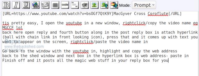

tis pretty easy, I open the youtube in a new tab, rightclick/copy the video name eg MGCCF lol -don't close that tab yet yet though
back here open reply and fourth button along in the post reply box is attach hyperlink (ball with chain link in front looking icon-between U and an envelope), press that and it comes up with text you want to appear on the screen, rightclick/paste the video name in or just type what you want to appear on the post as the link name....
Go back to the window with the youtube in, highlight and copy the web address
back to the shed window and next box in the hyperlink box is web address- paste in
Finish off and it posts all the magic web stuff in your reply box for you
It should look something like the top line in this...
If you want to test it and see what it looks like, use the preview post button next to the post reply button...
Edited by Boppa 2018-12-28
