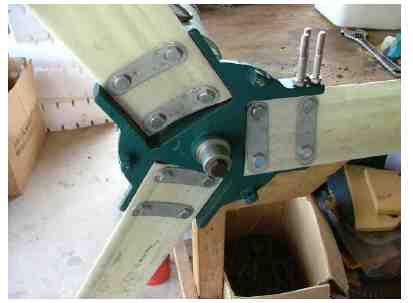

i have a 3 set of fibreglass pulltruded blades that came with a mill kit i assembled, they work well, BUT noisy, i have shaped them as best i can , but need advise to more shaping to cut down on noise.
they are contstant curved 1.2metrs each about 130mm wide.
Richard

I've heard those blades make a bit of noise. As they are a constant angle over the full length, the noise is most likely due to part of the blade stalling at any given wind speed. The perfect blade should have a twist. But hey, those windmills are a good price so who's complaining.
You could try rounding the tips, but I dont think this will help much. The best solution is a new set of blades with twist. I bought a set of 6 blades from EcoInn ( see the link page ) for about $220 AUD a couple of years ago, they run very fast and I think would work well on the windmill you have. Or you could make a set of timber blades, a lot more work but you can get good results.

It looks like the flange the blades bolt to is well made, so you should be able to try a few different blade types to see what gives the best results.
