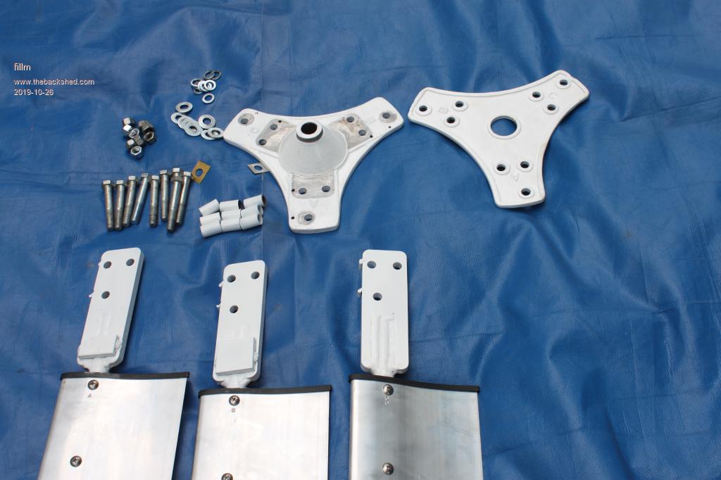

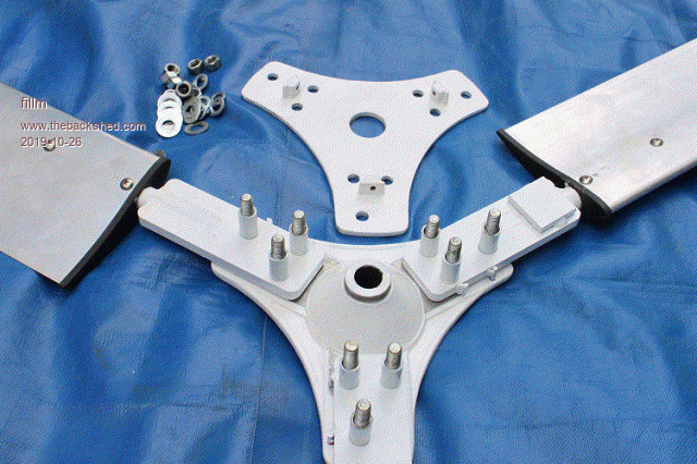

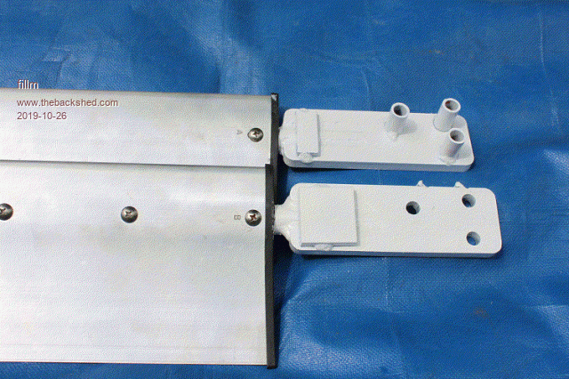

There is a solution to the noise and lack of power in light winds , fit the GOE 222 Blades . I  Have laser cut parts that I designed to easily mount to the blade hubs .
If you guys got a turbine from Huaya with no problems and a balanced lade set that is rare , I have seen them sending second hand  parts as well as burnt out generators. I should do a whole article on the 3kw Var Pitch that I bought in and all the problems ... one day. Its up and flying and with our mods is making over 150W in 1.5 - 2.5 m/s , and easily exceeding rated 3kw in under 10m/s
Below are some pics of the type 2 blade hub , if you can weld and drill accurately its not hard..
With this design I can get everything exact that cause the wobbles and vibration , by shims and internal weights. Our Blades run perfectly !!
Along with that you will get 2 x more accumulated power and better low wind performance ... GUARANTEED!!

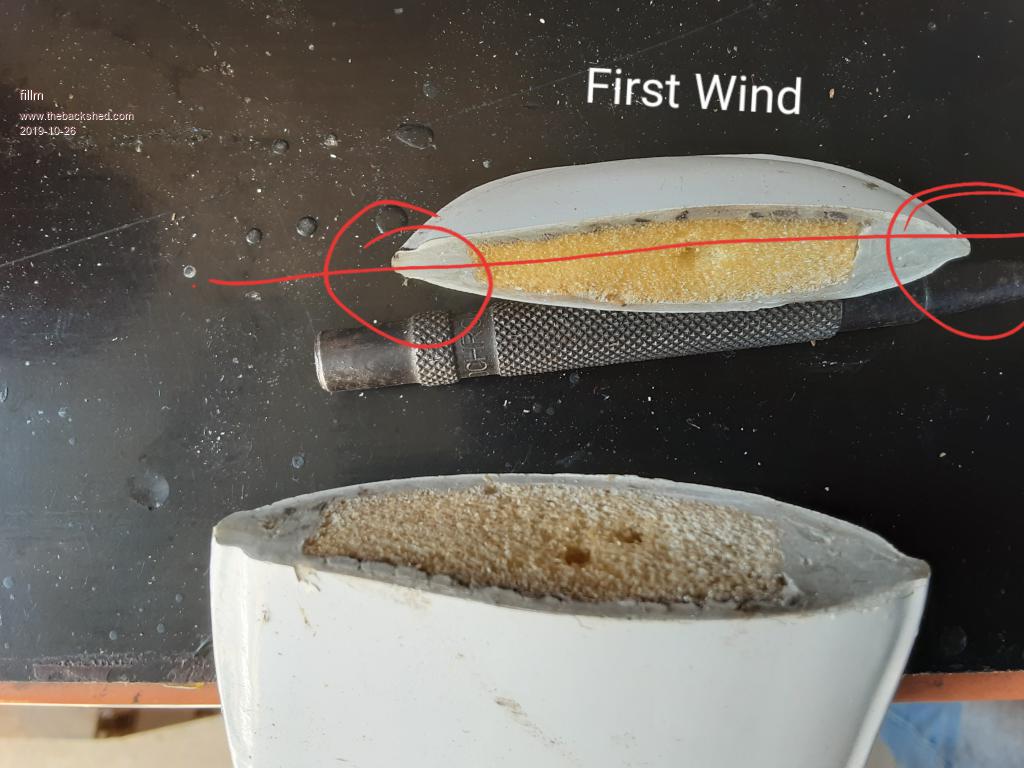

The Chinese Blades from Huaya , Yeneng , First wind ... etc.. have no true airfoil design to make a claim of, they just look nice to the inexperienced eye and mass produced, not even the widely could they use Clark Y ( Flat front & curved on the back )like on all the crap micro ( so called  300W ) type turbines.  the First Wind is the worst . If you think below is an airfoil that can produce lift , please explain how. IMO fence pails would do better .
The other warning I will throw out there is for the USA seller ..Like Missippi or such, I have countless inquiries on people ripped off " how can I get power out of this" Advise given " Throw it in the bin and ... WAY Better doing an F&P based turbine , at least it will produce 300W easily single stator.
Would you see  this shape on a plane wing ?

Nice looking hub and blade assembly fillm.  I assume the steel blocks are the balance weights.  Do you statically balance these as an assembly, or have another method?  Just curious.  I'm getting ready to balance a set of wood blades.  Regards, ~ks
