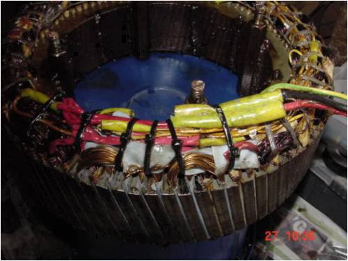

Well to keep Dinges happy, the stator has been drowned in mineral varnish (nothing else suitable I'm afraid) over the period of several days.
It consisted of heating up the stator next to the fire (Jamies wife refused to have it in the oven) until it was toasty warm, and dipping it into a bucket of warm varnish for an hour or so to get the bubbles get out of the windings, letting it dry next to the fire's heat, and doing it all over again.
It came out looking like this:

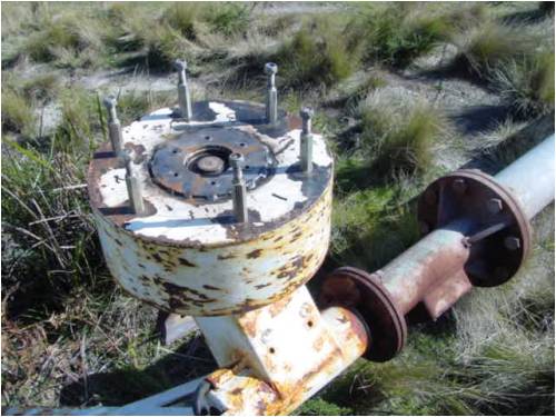

Jamie decided to use silicon as a spacer between the drum and the blades... I shuddered. At least we liberally spread grease all over the drum, so in theory we will be able to get the blades to release next time.......the jury is still out on this one.

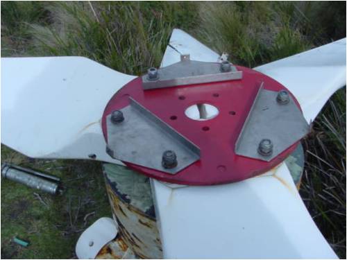

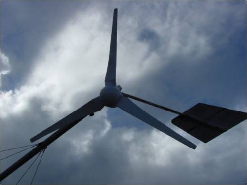

Here are the blades mounted with one of my axial flux discs on the front to clamp the blades. Originally they had only those triangle things, but the flexing up in this position kept breaking the studs. This 8mm plate stopped that from happening any more thankfully.

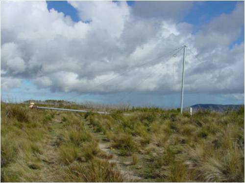

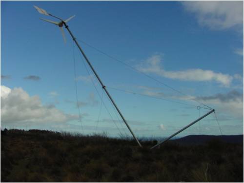

Here is a side on look at the gin-pole system.Some people may not have seen this ready to go so you have now. (this was before the blades went on):
Ok time to lift up a bit:
and more still. It can be seen how the gin pole system works from this:

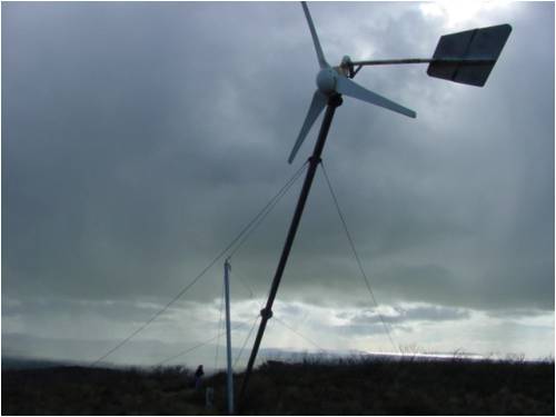

Looking North we see Jamie winching it up Note the change in weather from starting the lift to 5 mins later:

  oztules said   Well to keep Dinges happy [...]
Thanks Oz, you indeed made me happy. (or was it that hot chocolate milk I am drinking now ? Hard to tell...)
Strange wife Jamie has. Wouldn't let him cure the stator in her oven. Geeze... I bet she only uses it to cook cakes too ? Silly. (about a year ago I found an old pottery oven that I still have to fix a little (new thermostat) so it can be used for melting aluminium and baking out stators and drying/curing motors after varnishing. It's 3kW so not suitable for off-grid purposes, though Jamie's system would probably have no difficulty running it )
The local motor rewinding shop use both varnish and epoxy. They reserve the epoxy for rush jobs, but I expect epoxy would be better than plain varnish for this particular job. The downside is standard epoxy can't stand temperatures above 60 deg. C much. Perhaps heat the stator a little (40 deg. C or so) so the epoxy will become thinner and flow better in all the nooks and crannies. Anyway, I think I would have used epoxy to varnish, not varnish. It may make little difference in the end though, as the epoxy used by motor shops is a pretty different animal from your & my run-of-the-mill epoxy. It is supposedly able to withstand much higer temperatures but isn't as durable as real motor varnish.
