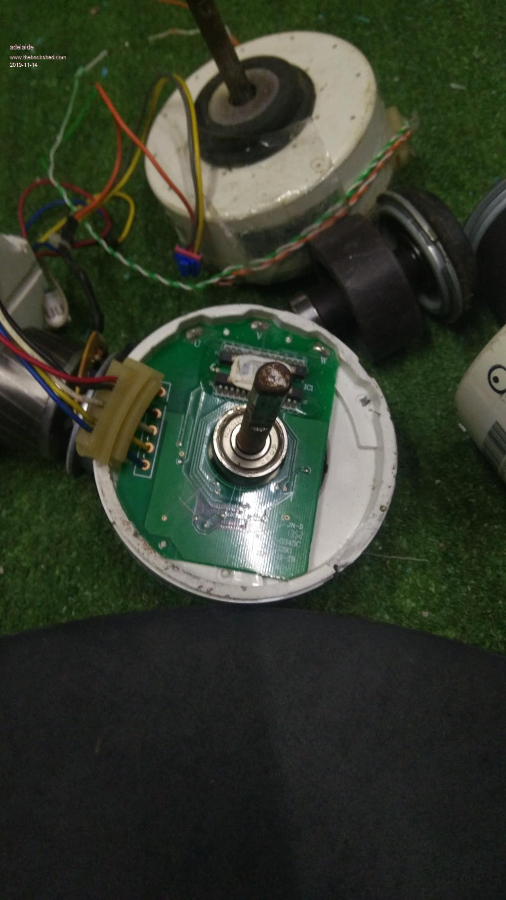

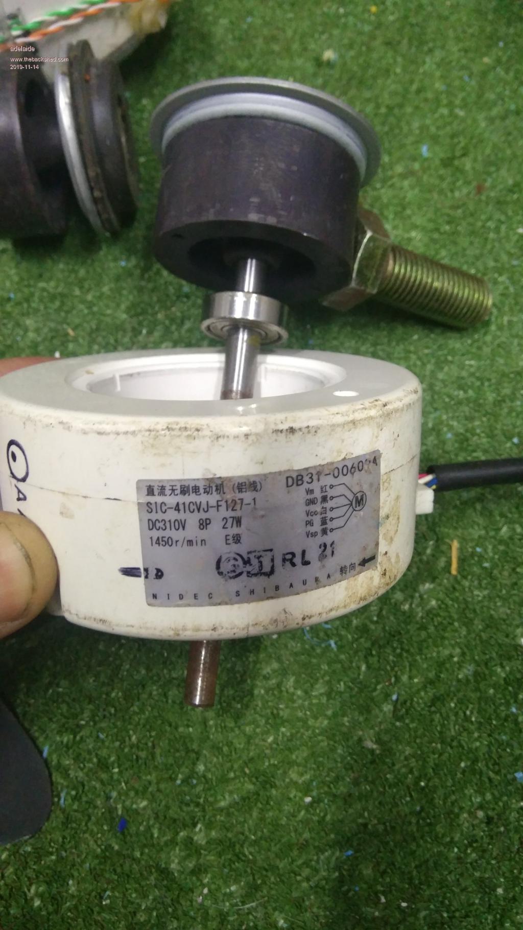

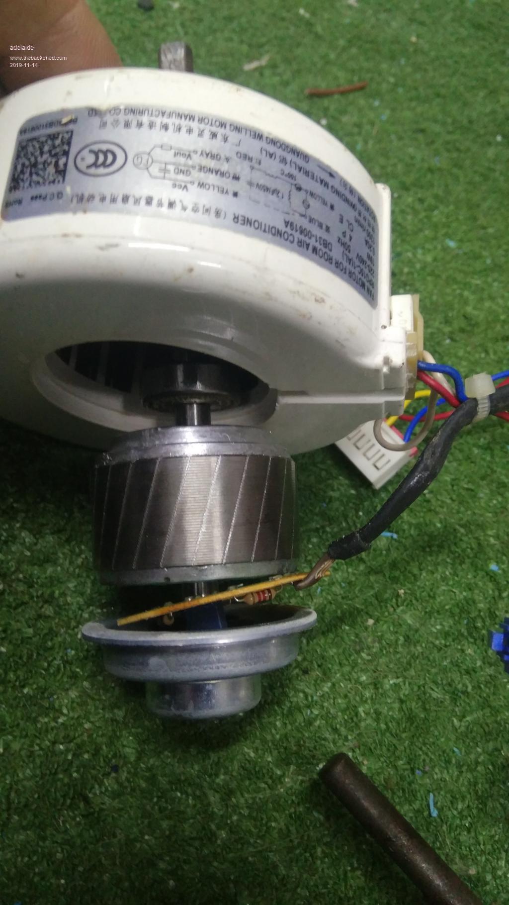

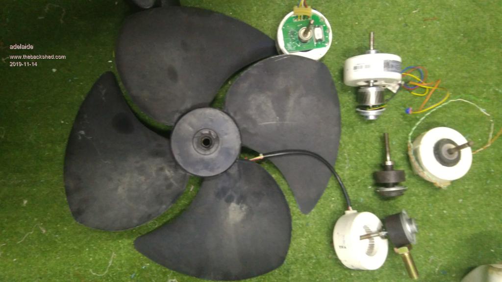

Hi got this motor out split system ac internal fan motor some have ac motor with cap some have better permanent mag 3 ph hi volt input with internal dc to 3 ph driver. seen occasional with problem and few variants, some you can get to the star points and centre.some only dc hi v out some 30 v 2 amps(if ever play with these some are dangerous voltages,if lo volt bat not connected easy can kill treat as hi volt)
looking for some brain storm on way to efficient and simple step down the hi volt,
bit testing on 1200 rpm drill is 120 v .4a ,is no cogging and fun small mill to play with trickle charger silent lo wind, direct connection to 12 volt is trickle charges with split system external fan blade with start up funny under 5 kmh hardly stops but is wasting power charging 12 v, when wind normal 15 kmh up it more suited to charge 60 v bat not 12 so...
(pics of the ac and dc pm version and split ac system external fan works well as small silent lo wind trickle changer)

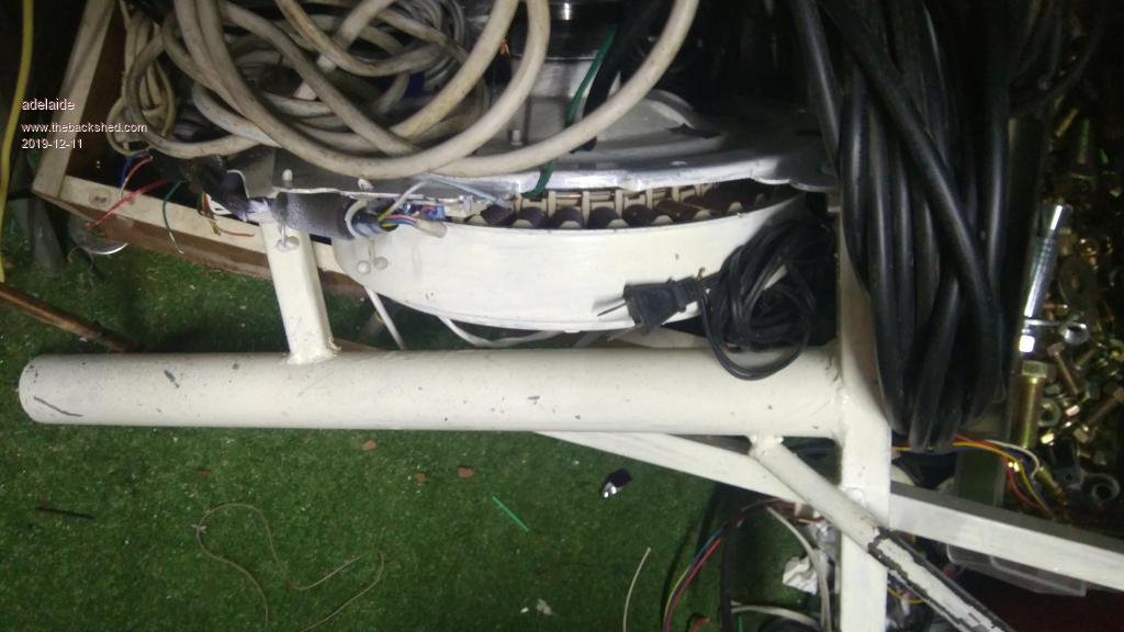

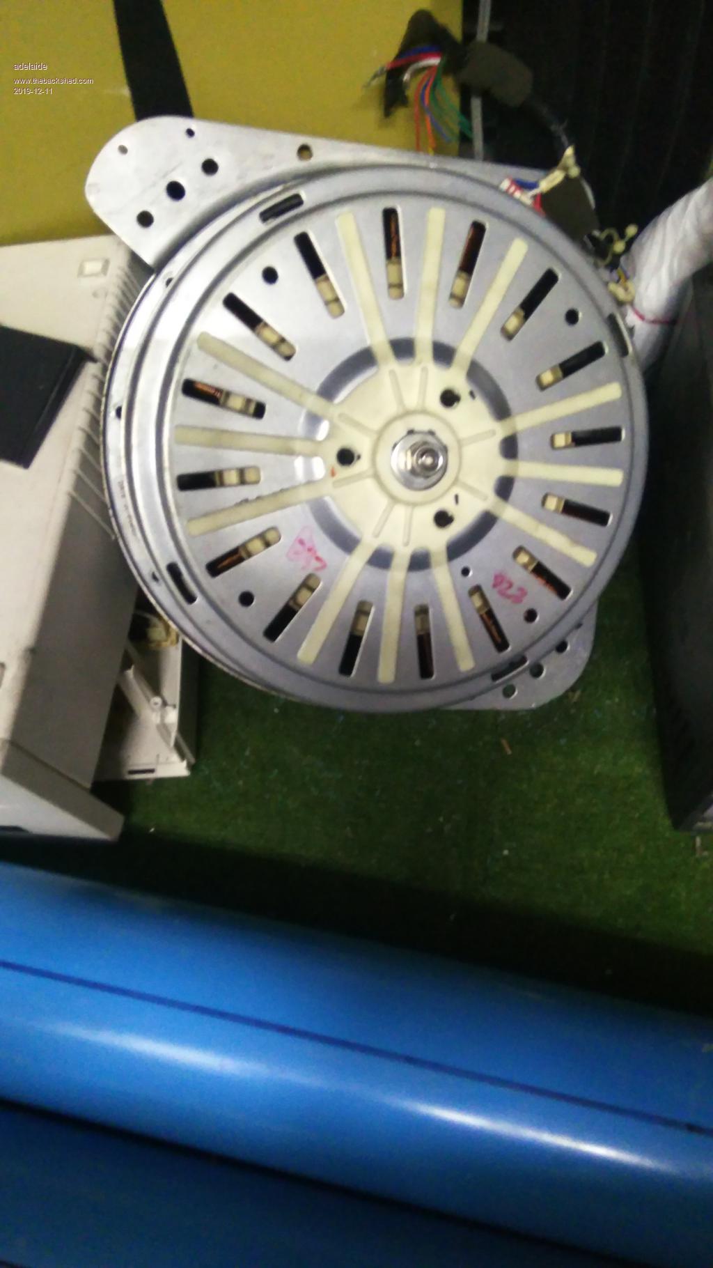

We got this bigger pm wash machine hears pic working on making furling mill with my Thai engineering gf funny she can weld and program better than learner me ha ha. has alloy wire but looks stronger than f and p and less cog.will work on stepping it down rather than re wire
