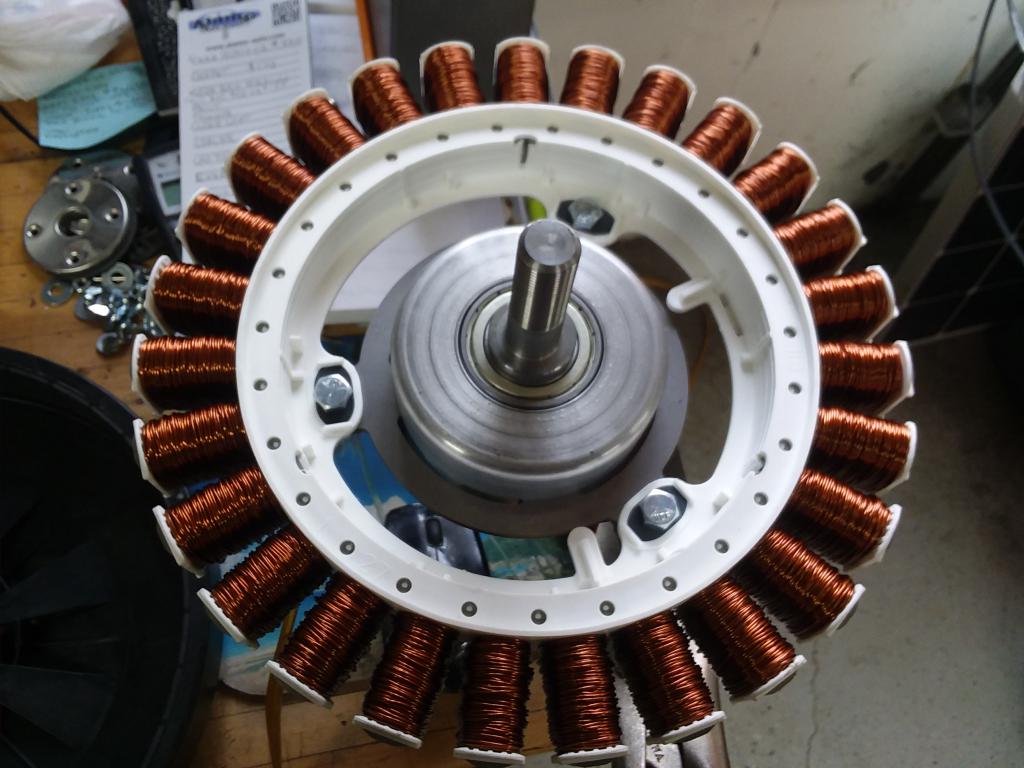

Thai
Joined: 22/05/2018
Posts: 30
Posted: 08:16am 02 Aug 2020
I fixed mine by stripping the wires and exchanged it to a 16 guage. Rewired to 3 phases with 12 poles per phase. The wires are too small and could burn out with high voltage. Unless you get a transformer thats the only way it'll work factory without rewiring. Better off just using the washing maching motor. Its cheaper and has more poles to play with. Missouri now sales these fp640. From what i hear, they don't care if you get ripped off. If i could go back i would spend 30.00 on a better fp motor. I also had to dip my stator in resin to keep it from weather elements. It's alot of work if you're willing to deal with the fp640. Only figured out how to wire it for 12vdc. Make sure you don't wire over 12 poles or it will break and vibrate. Lots of trial and error for me but i still haven't installed mine. Blades are too expensive at the moment. Watch my youtube for more info Nrgpowercharger
