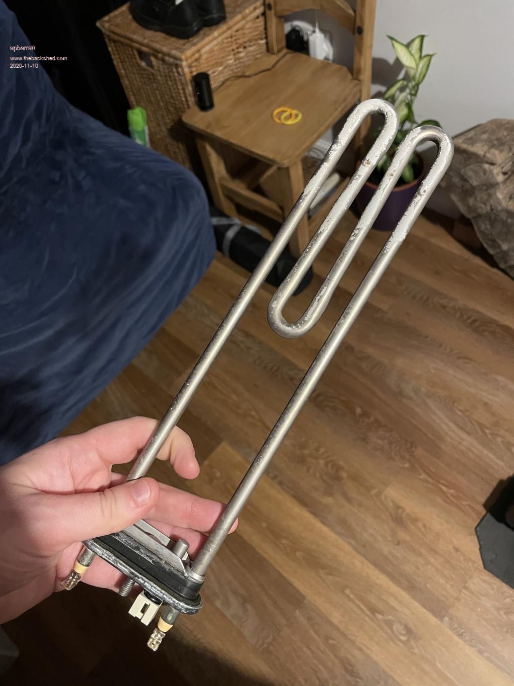

Whilst tidying up the remains of the LG washing machine I took the direct drive from, it occurred to me that I also removed this immersion heater from it.  I was wondering, if I'd be able to recycle this to use as my dump load?
Has anyone done this? :)

As the name implies, you will have to keep it immersed in water. Otherwise, why not?

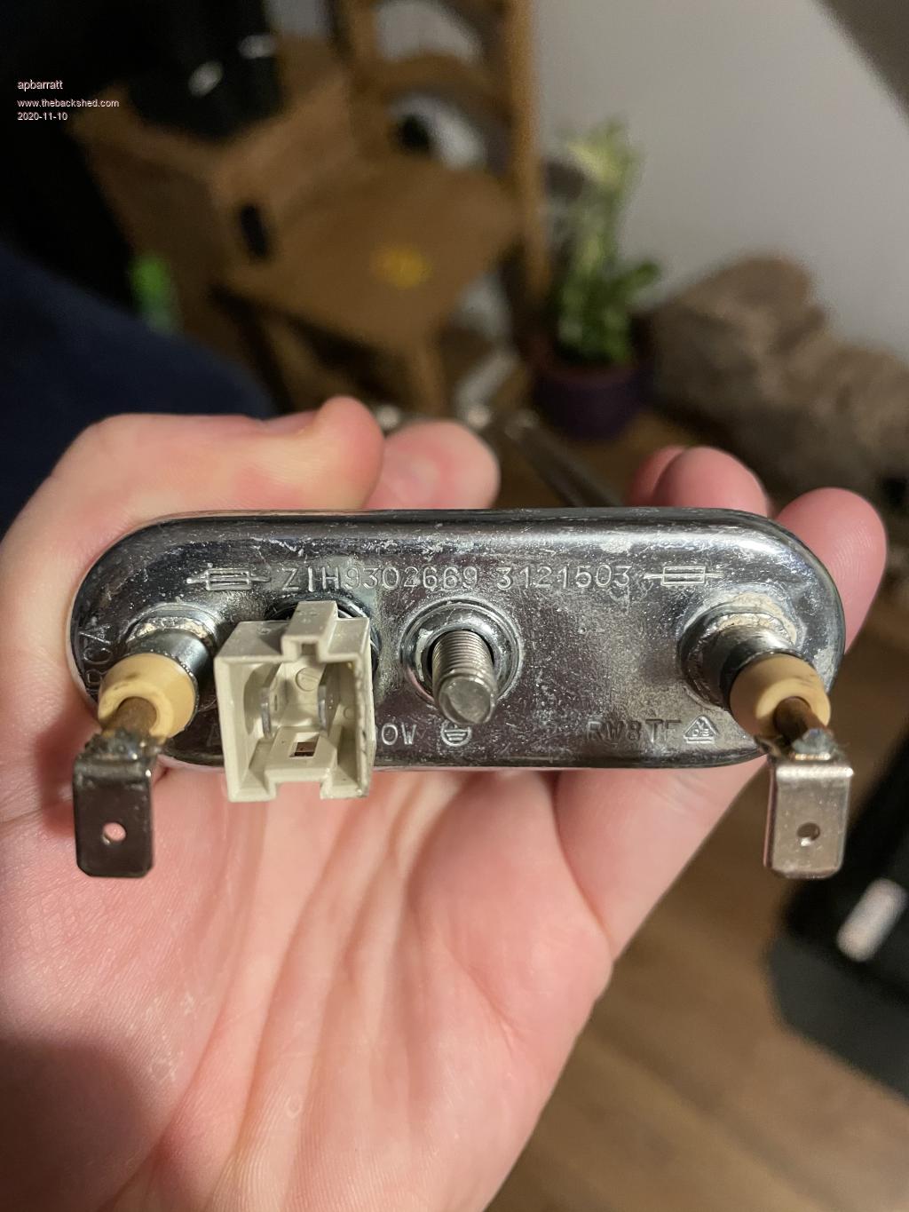

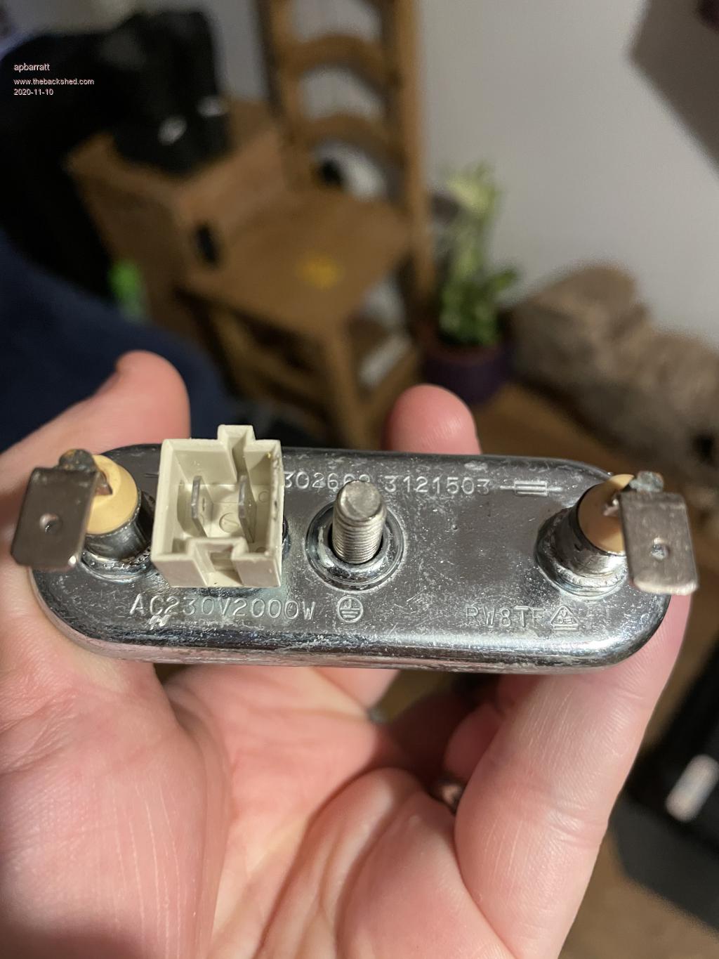

From the markings on the heater (2000/230), I get 8.7 ohms of resistance, and of course the 230 volts is marked on the plate.
And before anyone asks, it's good for 2000 watts, but probably only when immersed.

I didn't know washing machines had heaters. Dish washers yes, Fridges yes, but not washing machines.
Was it a front Loader?
Looks like it has a Built in temp sensor as well.
I have run water heater elements out of water at reduced power. If you have a few you get for nothing, you can afford to see what the limit is. If you only have the one, probably best to sink it and be done with it. They will only take a fraction of their rated power in air.
If you want an "air cooled" dump load, 500W halogen Floodlights are pretty cheap.

Its 2Kw at 230v, and with 230v it will definitely need to be immersed.
But with (say) only 23 volts, one tenth the current, and one hundredth the power = only 20 miserable watts will be dissipated.  It will get very barely warm.
No need to immerse that !
So unless your system is of an unusually high voltage, it should work pretty well.
In fact it may end up not being powerful enough to dump as much power as needed.
