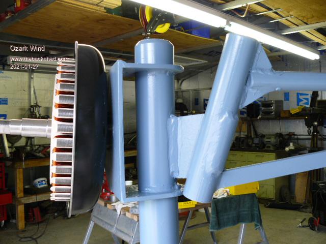

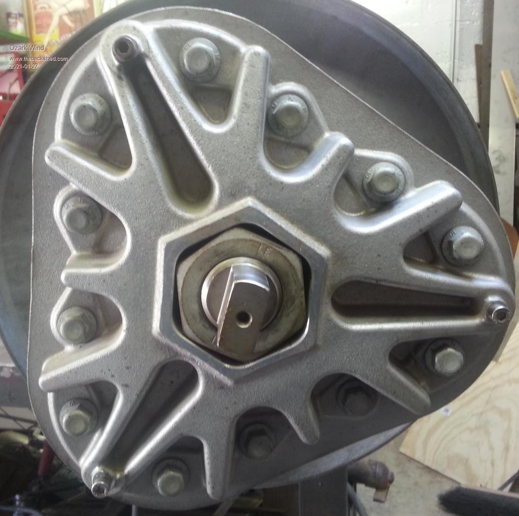

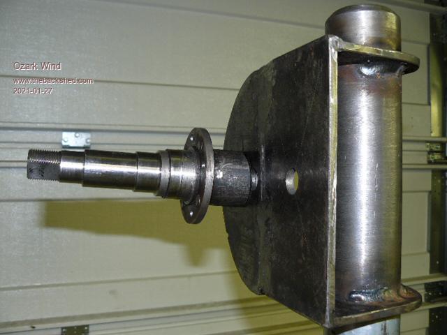

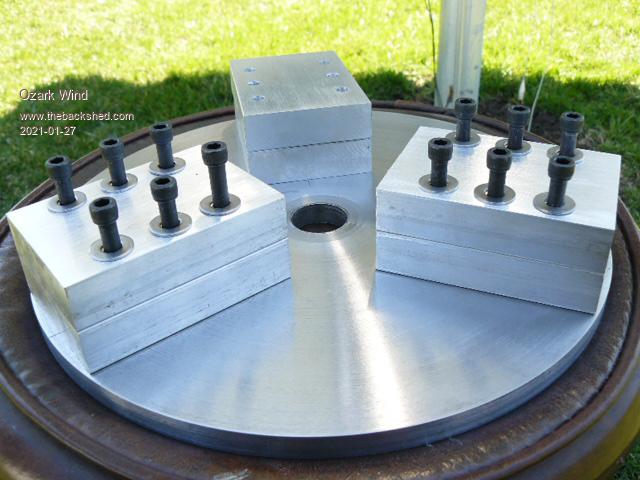

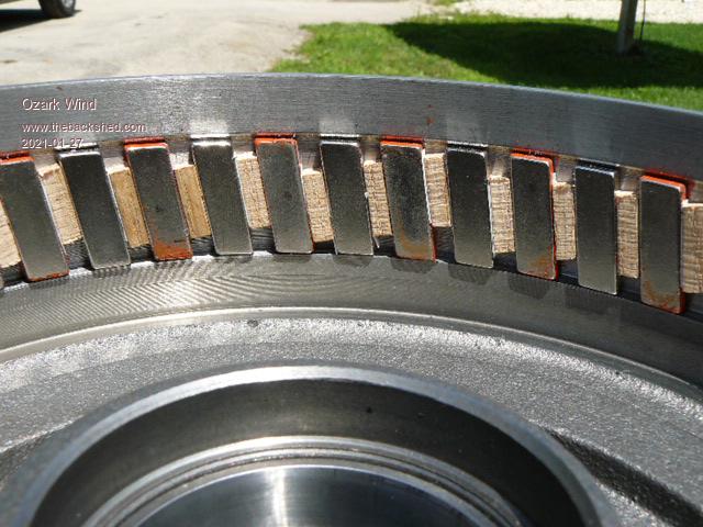

  I was at one time a member of the Backsheds wind forum. I was seeking and asking advice from forum members on how to design and build a wind turbine generator based on an F&P stator motor. At the time I found the build very interesting, enjoyable and learned a ton of knowledge about wind energy and how to harness it. I want to thank the forum and its members for giving up their time and knowledge to see me through the build. I have uploaded some of the photos from that build. The F&P mill would average approximately 300 watts and did peak at 700 watts but only once!

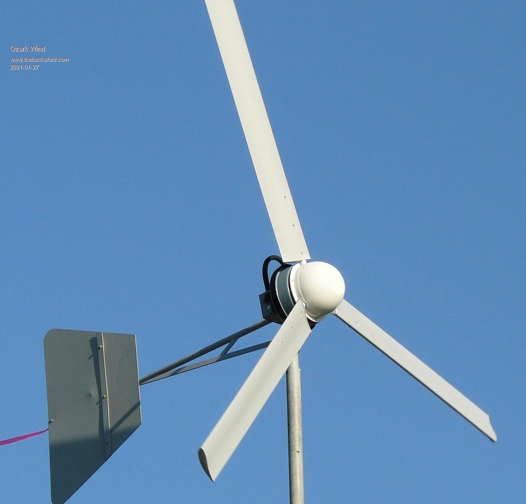

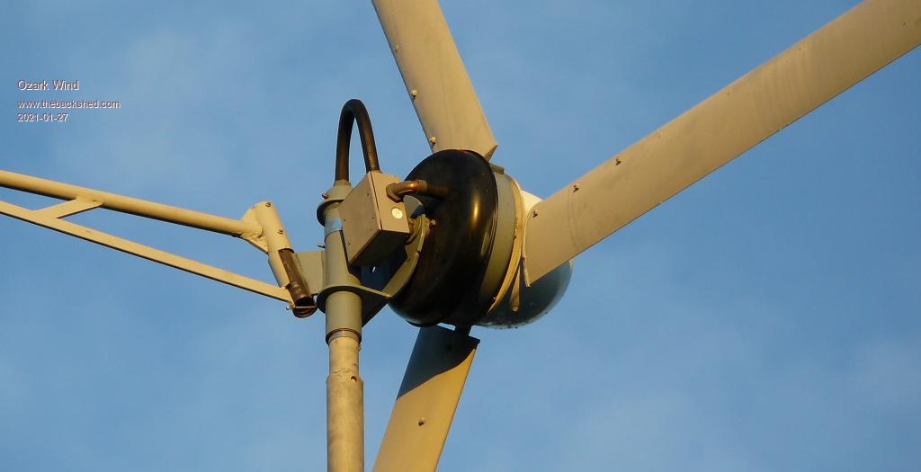

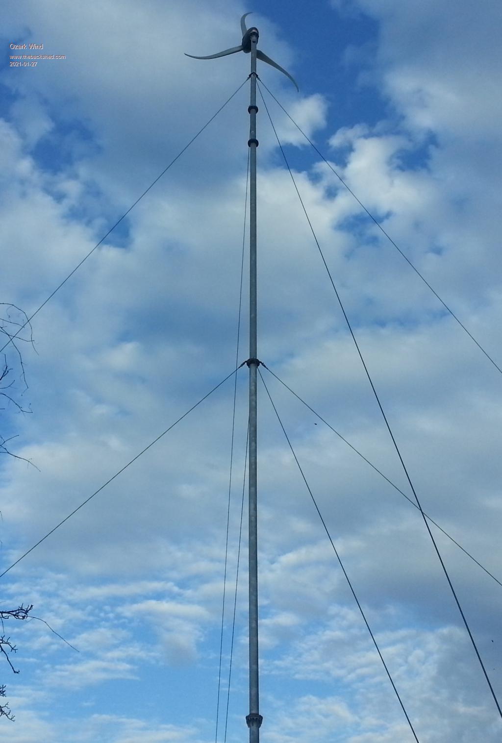

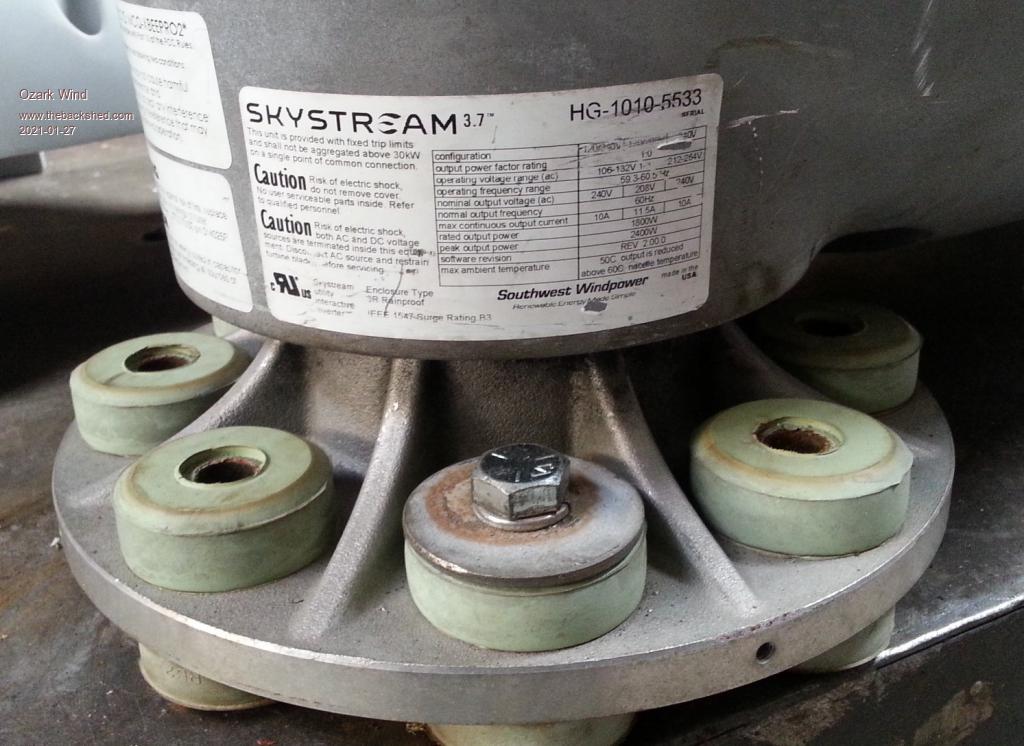

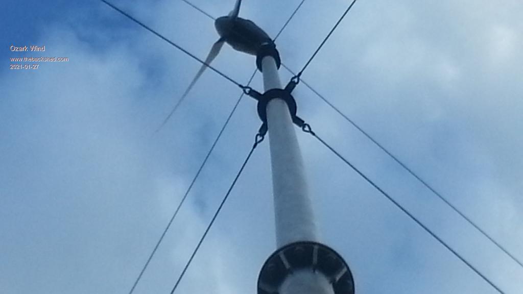

  Back in Illinois I helped a neighbor install a wind generator on top of a 75 foot pipe style tower. The mill was at that time sold and or manufactured by Southwest Wind Power or Southwest Wind Power Skystream 3.7. The mill was flown for approximately one year then it just stopped. I think the Skystream definitely came with its own share of problems I believe it developed a deserved poor reputation. The Skystream came equipped from the manufacture to be a grid tied. The electronics needed to accomplish this were installed in the nacelle from the manufacture, RPM/voltage, power curve, cut in RPM, the inverter, anti-islanding etc. Personally I think that housing the electronics in the nacelle of a wind turbine which a place not easily accessible is problematic.  The Skystream is a downwind mill it does NOT have a mechanical brake or a tail furling over speed control. The RPM is controlled with dynamic braking ONLY. The owner's manual says the PMA has five times the torque than the blade set can produce.

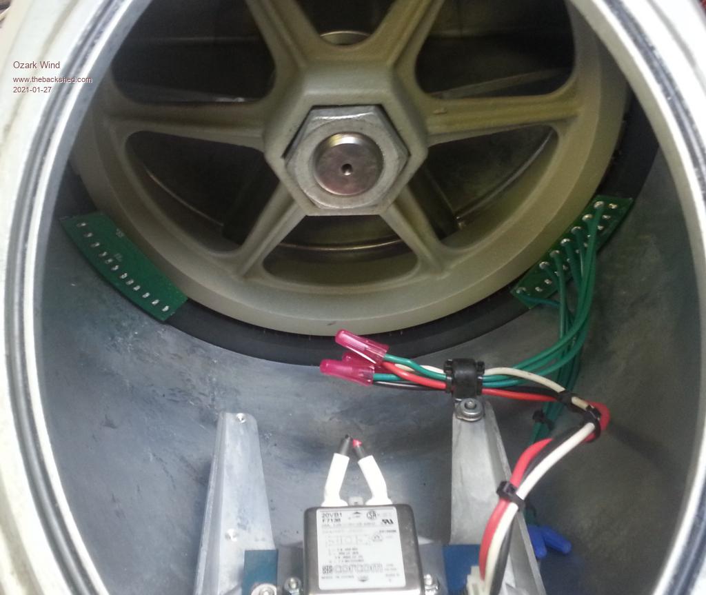

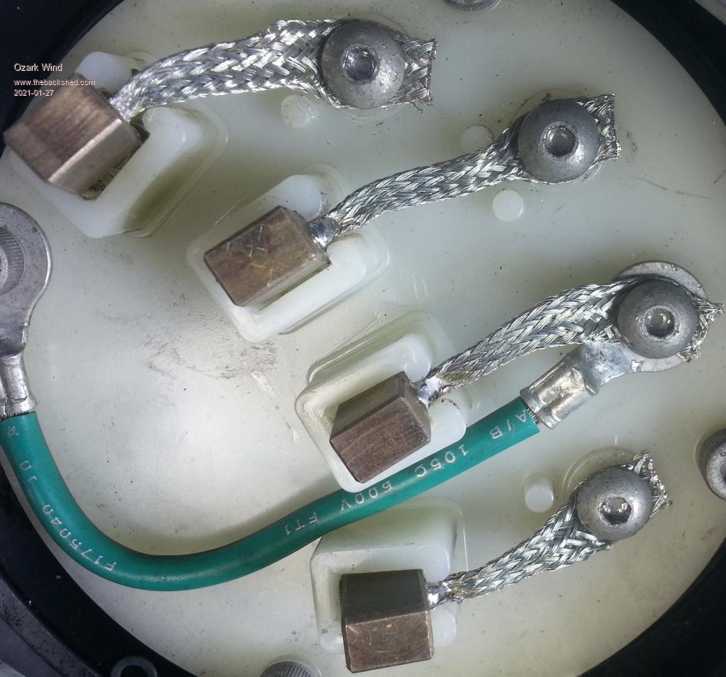

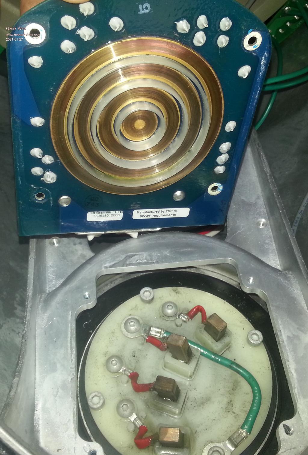

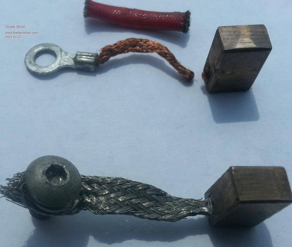

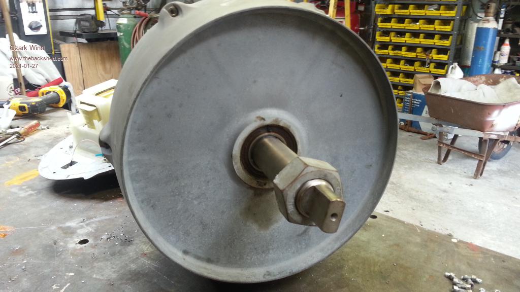

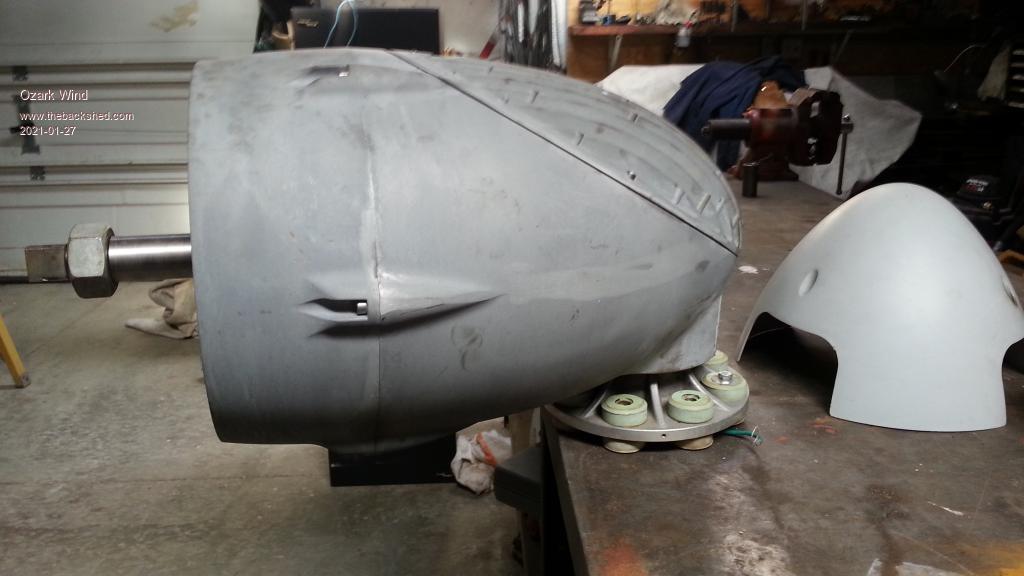

After removing the top cover of the mill I noticed that one of the wires from one of the pickup brushes had broken this I believe was the reason the mill stopped operating. I did do some modifications and replaced the old existing pickup brush wire and also replaced the existing brush wires. I did not replace the existing pick up brushes they are still like new.

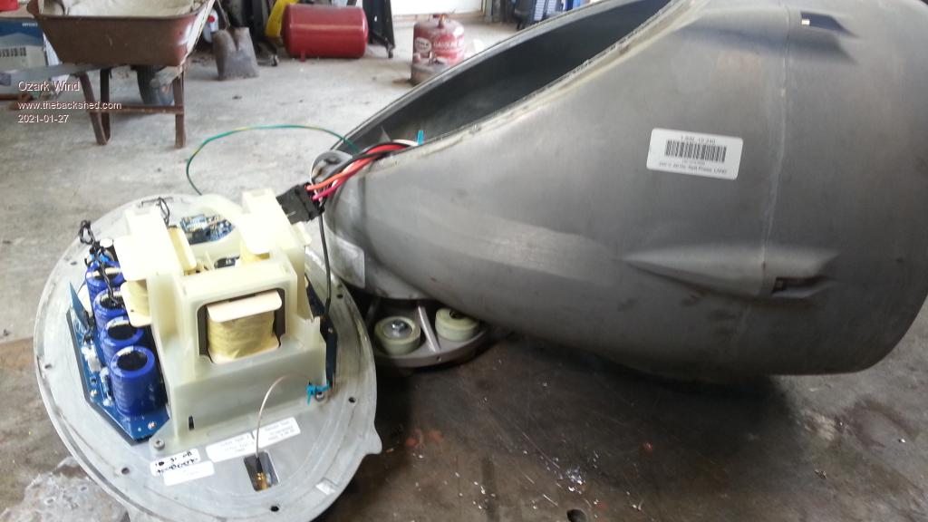

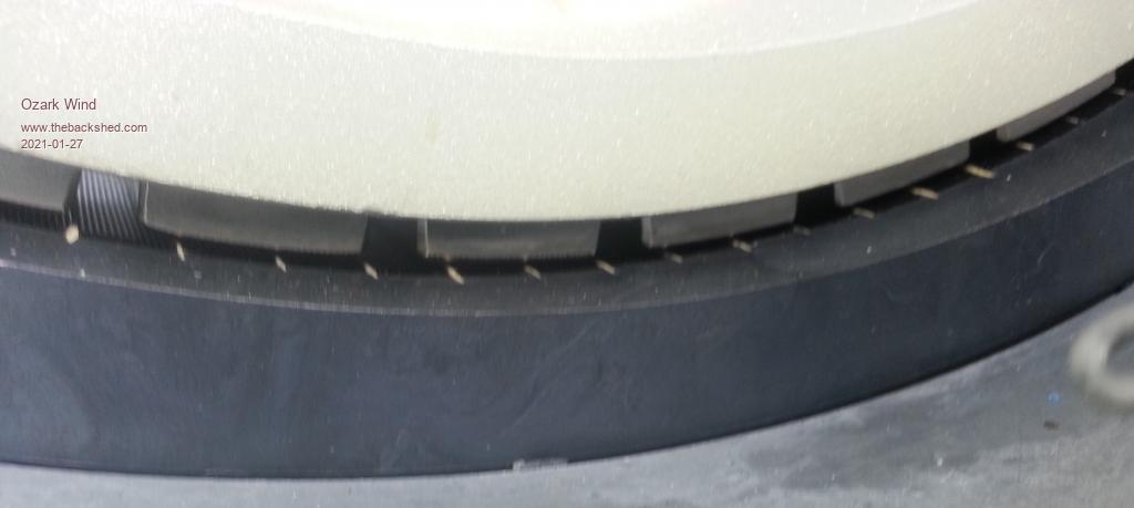

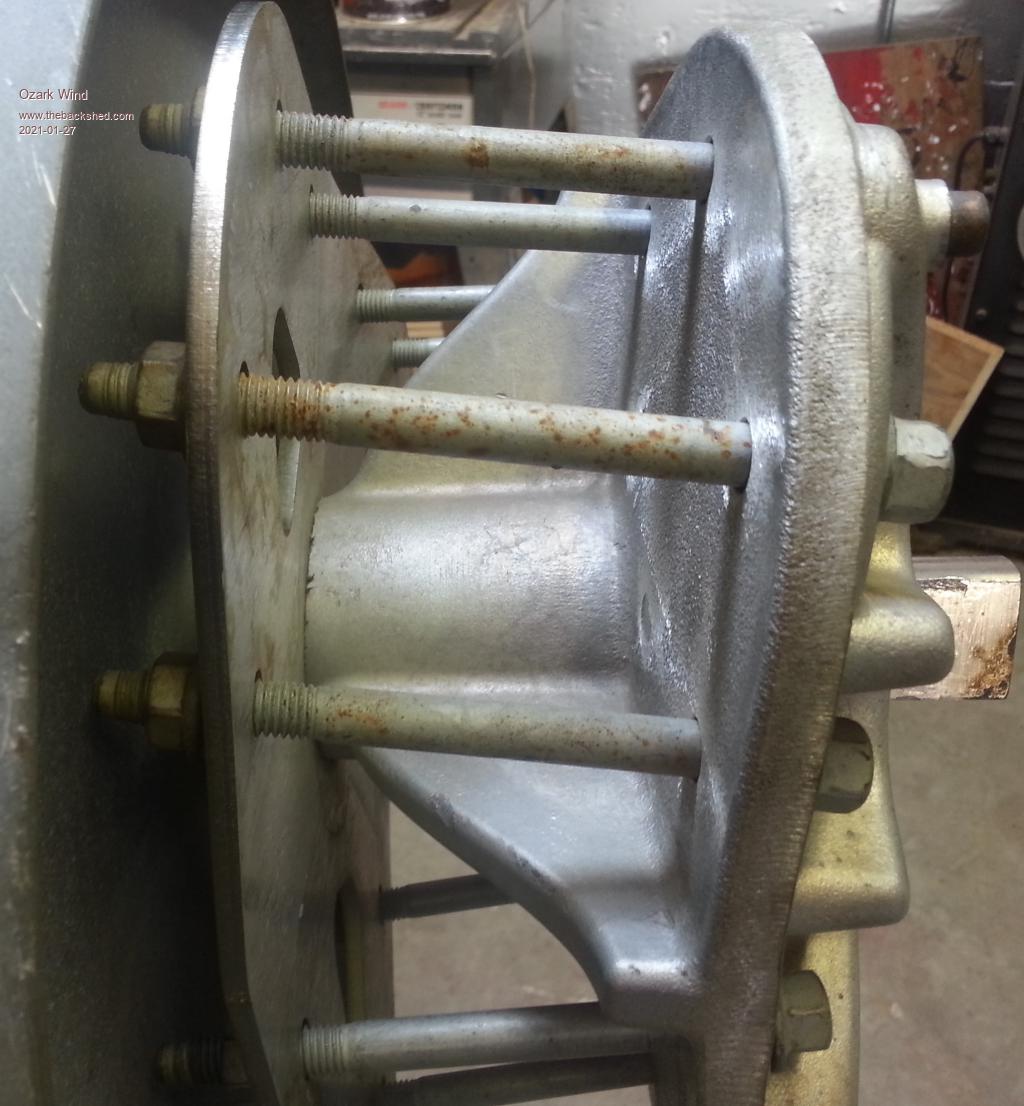

After some thought I decided to gut or remove all the electronics from the mill thinking that I will fly the Skystream with a ground based control system. The mill itself is in VERY good condition its housing is made of aluminum with large Japanese bearings, fiberglass curved blades, slot less neo magnets etc. I connected my volt meter to the PMA and spun the input shaft it does put out power. The mill is basically new or barely used.

Wow that's an awesome build. What size (dimensions) and strength Neo magnets did you use? (it looks like you converted it)
What motor model did you use?
Did you rewire it in any way? Is it copper wound?
