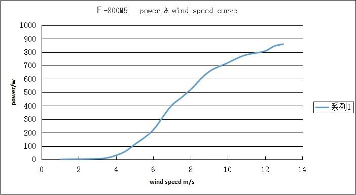

12V 800W Smaraad F-800M5 aka SM5-800 (Made in China)
I cannot verify who the manufacturer really is but it may be this company.

Because nothing I have read or seen of these things has confirmed ther stated output.
Looking on fleabay I see ridicilously exaggerated claims for these things. 3000w and selling for $149. If I thought they had a hope in hell of doing that I'd (and im sure others would too) buy a couple and put them on a diesel engine to make a generator.
Looking at many ads i see things like a claim of 3000w peak, 1000w constant.
Have enough experience with Chinese seller lies no to see these red flags.
for example what capacity do many car alternators have?
A 80a car alt will do around 1000w.
Knowing the power, speed, cooling and size of the units makes me extremely suspect on the ability of these turbines to come close.
Have you looked at the windspeed these turbines need to make the claimed power and compared it to what you get in your area?
Id waget that a 25% reduction in wind speed results in a 50% at least reduction in output.
Be interested to see how you go with this but wont hold my breath  with you gettingnmore than 2-300w out of the thing.

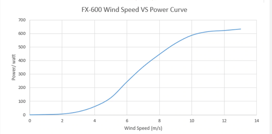

Technophiliac, I have done some research looking at various smaller vertical turbines, this one is interesting, it appears to be quite well made, bit pricey to get to NZ; Power output curve is similar to yours, if it can be believed.
FX-600
Regarding a suitable controller, seems easiest use an off the shelf suitable sized mppt controller from another bigger turbine, rather than attempt to get multiple ad hoc controllers to load share. I will be designing one and publish details on the forum, but will be awhile away.

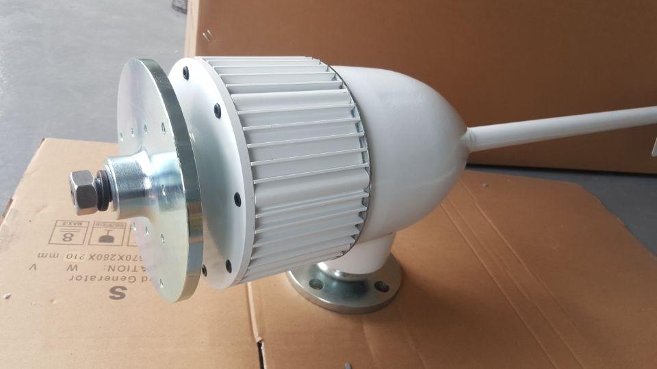

The generator component appears of similar quality to the picture of the above 12V generator. The bearings have no discernable play for what that's worth! Who knows how long they will remain like that but its a good start.
The generators can also be bought separately. I speculate you may find it difficult to do better than one of those as the generator component for your custom home vertical turbine but respect you may wish to exercise your skills and I cannot yet vouch just how robust these things are.
