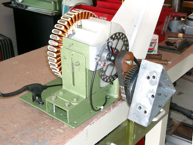

Why not use a small servo to activate a disk brake or something like that? Mountain bike disc brakes weigh nothing... They are pretty powerfull too...

  Chris said  Why not use a small servo to activate a disk brake or something like that? Mountain bike disc brakes weigh nothing... They are pretty powerfull too...
Where this all started was on a commercially constructed, fabricated and supplied gen, complete. Pulling it apart to add things like brakes etc is at best "impractical".... given things like warranty etc, but there is also (on mine anyway) no room to do it. The space from the front of the machine to the hub is virtually nothing, and I can't get to the back of the shaft.

Posted: 04:12pm 30 Mar 2006
Try this -it worked for me .   I rigged the disc brake  caliper with a fishing line down the tower-pulled it to stop the mill --chatters a bit when pulled on at first but once th emill slows it stops it .
I'd go for a motorcycle one next time- a bit beefier--

Rossw: Thats fair enough thats its hard to add it to a already built system.
But on a system that your building, it wouldnt be too difficult to implement the disc brake system. With the F&P system, like glenns and most others. There seems to be alot of shaft room between the prop and the stator. You could fit it there.
