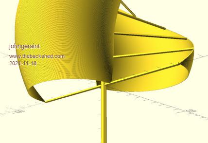

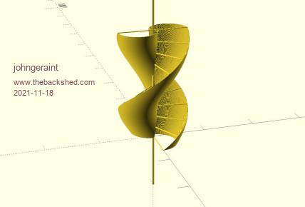

New to this forum,but I thought someone might be interested in some work I did a while ago on a VAWT design.
We are currently building an off grid home in Gretna TAS and my partner has threatened my sensitive bits with damage if she catches me working on this VAWT project instead of getting on with building.
Take a look at the uploaded spreadsheetfor more details

Looks good, should be plenty of good winds at Gretna, probably best to go for a vertical turbine there as the wind funelling down the valley would probably have a bit of turbulence.
Have fun with the house building.

It's a VAWT, so you've got all the insoluble fatigue problems to face. Also, a drag machine, so efficiency is all nah. Fun, though.
