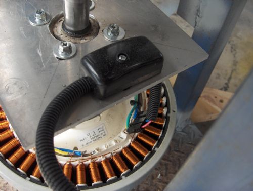

have built a Lenz 2 vertical wind gen and have found a F&P motor old 42 pole type ( 60 series I think from reading the forums ) .
I have rewired it as per the imnstructions and used some rectifiers to go from Ac to Dc output .

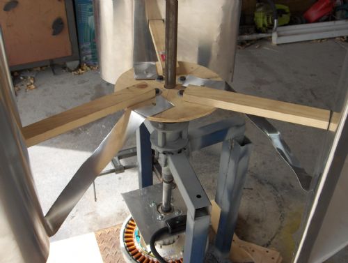

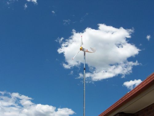

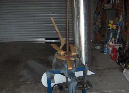

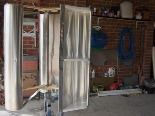

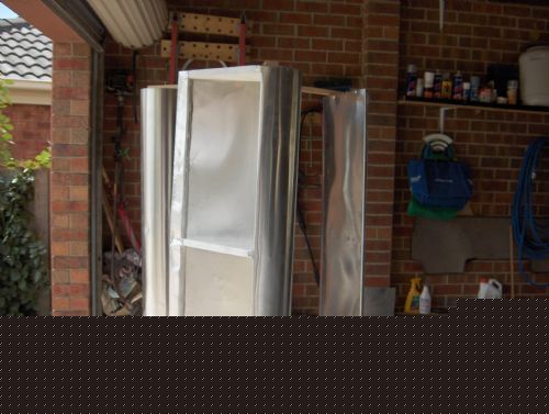

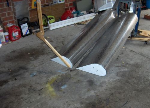

Hi Gentlemen,
sorry up loaded the chinese mill I have up already , after a remake it produces good power and traks the wind much better.
The photos are of the lenz2 that I have just made , this is just the mock up as I am awaiting the steel disks and then I can make the metal arms and weld it all together.
this will be the permanent item , hope it producs as much power as the chinese mill.

Hi Daz,
this is a bit of an unknown as yet,today I had it hooked up as it would be in a permanent situation
and it was very windy here in rowville .
Actually we had a storm come through, prior to this the gen was running at about 20 to 30 RPM and showing abput 6.3 volts , as the storm hit the gen went crazy and as doing about 100 rpm and then in a momement it was pushed over and some what destroyed .
Alas it was a porototype and I am waiting for the matal circles to be produced and then it can be welded together and be bullit proof .
Please note these figures are taken on the ground ,not up in the air.

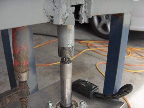

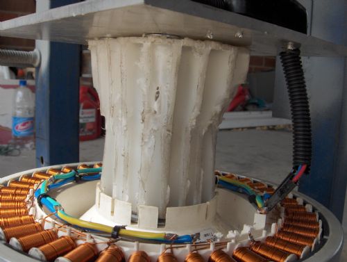

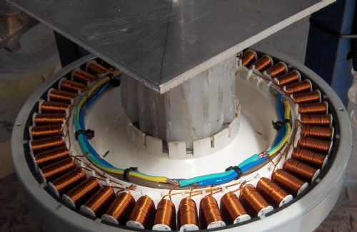

However after this happened I put the gen in the work bench and spun it up with the drill , I noticed ( with it connected to the battery bank ) that the power needed to spin it up so as it made some amperage ( only about 6 or 7 amps ) was huge .The drill nearly had a hemerage after I gave it to it to see how much it would put out , the more it produced the more the torque it required . Lots of power needed to make power.!!!
I will up load some pics to see what I mean.
Reards
Greg
loving life lets be active .
Posted: 12:10pm 22 Jan 2009
Hi Greg
Sorry to hear about the mishap. Its a nice looking machine so far, will be interresting to see how it runs.
Once you get it back together, measure the output voltage and get back to us. The rewire you've done might give a lower voltage than you need for this application, but thats easily fixed with a soldering iron. Thats a 80 series stator, and you've done a very neat job on the rewire.
