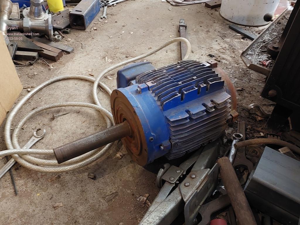

           Well over a decade I started this project where I scored a 4Kw motor that had water damage. It didn't matter to me as all the winding were taken out and warmed up several times to ensure the motor was free of any moisture.
Using an old Warman Pump shaft I made a new rotor and put 22 N50 16x13mm round Neo's in  each of 4 poles. The magnets are on a 10 degree skew to eliminate cogging and after the one wire test 3 in hand 1mm wire was put in the motor, now the amount of turns etc was lost on a forum many years ago.
Doing a lathe test several times showed the same or close result, the VFS for the lathe in 5:1 back gear complained of over current and with wild AC going thru an old 100 amp bridge rectifier that let the magic smoke out after the fourth test.
I was using 2 truck batteries in series for 24 volts and saw at 240 RPM a flash of 85-92 amps.
Then it has just sat in the corner until now when i do think it's time to get this project in the air.

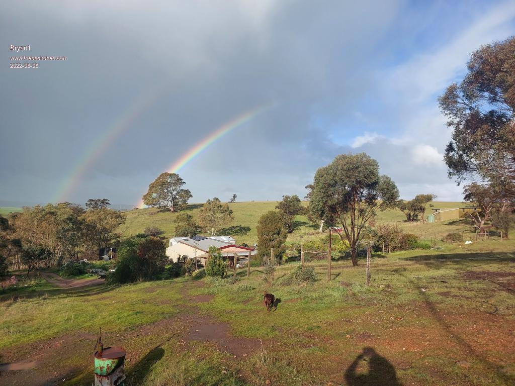

Here is the planned site which is on the right of the pic where the top of the hill is.
here is a pic of the conversion

Nice site up there on the hill, You have more room in your shed than me.
Cheers Aaron
