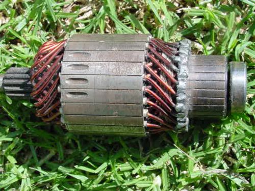

Yes Gordon, I rewound one of these reduction gearbox/starters recently (from a Mazda Bravo I think it was). It had field windings, but only a small armature. Luckily it still was only 1 turn per wave... so yes expect very high speed, very high rpm/volt... I have played with the perm magnet ones from the Honda's too.... wicked cogging... to put it mildly.
This is the one from the 4X4 Bravo.... so small. The bearing on the end is a little 629... like the ones on the vacuume motors on your vacuum cleaners....tiny things.
(Comments about the shoddy rewind will be ignored ... yes it worked too.)
........oztules
Edit: Gordon, if you look at the slotwidth on the armature,.... well, your not going to get decent wire in it, so you are reduced to feeding the wire through the slot from end to end, wire wrapping is not an option. Edited by oztules 2009-02-08
