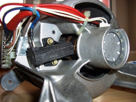

I've been reading some of the other post's and see it could be possable to use a washing machien motor, I have an old Zanussi top loader in the garage, I'll strip the motor out today and post a picture on here later.

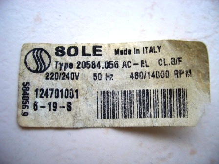

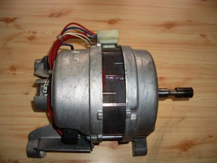

Posted: 12:50pm 26 Feb 2009
HI All
Here are some photo's of the Zanussi motor...
Is this a good candidate..?
