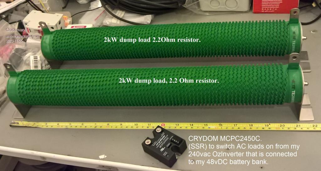

I use these........ 1ohm resistor or these 2.2ohm
They can be parelled up.
I use them to dump 9Kw at 48 to 60vdc, but 24v, your cables to each are going to be huge and thick for that kind of amperage.
