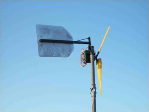

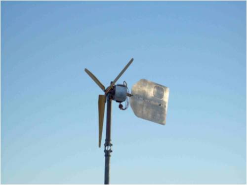

This is my first attempt at a generator of any size. It has a 1.1 metre blade diameter using pvc. The gentle annie motor is wired up using the high impedance windings and connected in delta. Bridge rectifiers mounted on top and dc wiring down thru mast. I'm having some trouble with the yawing side of things and it doesn't track the wind well until wind is strong. The gentle annie motor is bad for cogging but I didn't want this generator to run all the time (only charging battery for jump starting)so not a huge problem. I'm happy with it as a first attempt but I'm learning so I'll make some improvements for my next generator. I spent only $10 all up so I'm happy.

Extend the tail back another foot or so, and this will help with the pivot into the wind. Is this furling?, the design looks like it will move (If winds arent too strong out there, then you may not need furling. I used mine for months without any furling at all).
Also note your blades may be too close to the pole. PVC can flex especially under strong wind, so best to move them forward a bit. Try a bigger blade set as well for more power -remember, the higher the blade sweep area, the more power can go into your motor. Mine is about 2.2metres.
I think its a great start. You tend to look everywhere for parts you can scrounge to use, such as pvc, metal pipes etc. Its almost addictive.
Keep experimenting, and learn heaps.

Thanks for the feedback Rob. The tail is furling but I have locked it up so it doesn't. I'll extend the tail and see how it goes. Will make some bigger blades so it starts a little easier. The alternator is mounted forward of the mast so the blades shouldn't hit the mast. I think it's just the angle of the photo. I'll give a 1 metre blade design a go so diameter should be similar to what you suggest.
Most of the parts come from the junk yard including the gentle annie motor and a box of bridge rectifiers/heavy duty relays.

What voltage output are you getting? Is this an alternator from a car ? as most alternators wont get enough rpm for the right volts.
Larger blades (I used 12 inch pvc pipe for mine), help out very well. but it will be a compromise between wind capture area, and weight. I remember finding my pvc, halfway in the dirt in a muddy backyard. I wasn't sure if it was sewerage I was washing out, or not.

I agree with robbo, the tail needs to go further back to make the windmill stable, especially in light winds. An extra foot would make all the difference, but go for 2 just to be sure

Thanks for the replies. The gentle annie motor is an early f&p washing machine design. I'm getting about 400-300mV above my battery voltage in strong wind. Not sure about current (no ammeter installed yet)but my battery voltage is normally about 1 volt higher after an hour of strong wind. As I'm only jump starting the rideon weekly with it I'm happy so far.
Will mod the tail and make some bigger blades. I'm keeping an eye out for some large pvc pipe. No luck yet so stuck with 100mm.

Not sure how good the gentle annie can do, but the Fisher and Paykel on this website produce up to 300 watts per motor. Thats up to 25amps. I've seen my batts skip way over 13.7 volts when it is charging. Sometimes up to 16 volts. (this is a very inaccurate way of measuring amps!).
Yours might be doing 1- 2 amps at a guess.
What revs per minute are you doing? If your wind is big, then maybe you could get a lot more out of mills ?
Hint : if you dont have a windmeter then geuss, is it doing more than 1 rev per second (60 revs per minute)-low speed), or 2 revs per second (120 Revs per minute) etc.

The gentle annie isn't the best alternator around but it was a simple build first up with plenty of studs protruding from the outer housing for mounting. I think a couple of amps during a good blow is probably correct but I don't need much more than this at the moment. The best thing with this smaller mill was that the mast assy was easy to construct. Anything larger will need more height and support cables so it gets more expensive and time consuming. I'm just taking small steps at the moment. Eventually I would like to have a battery bank that powers all of the loads in my 2 sheds and my garage. This will take some time so I'm just playing for the moment.
