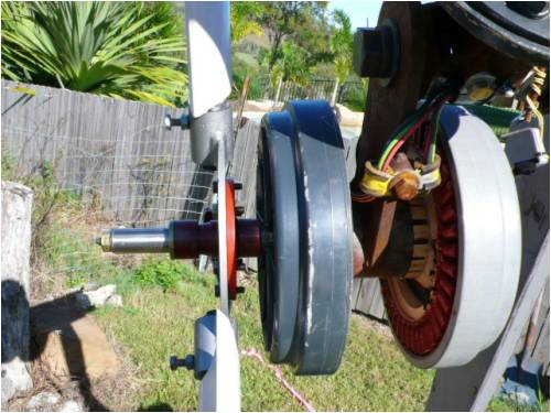

I took delivery of a set of the new PVC blade extrusions last tues and set about making the mounting hub to suit my dual F&P and the AxFx which will be ready soon.
The first thing that hit me was how little flex the blade section had so I decided to use up some 25x1mm S/S tube as the blade supports and go 800mm in a 1.4 length..

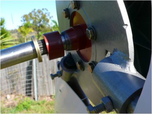

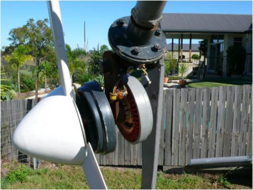

The hub I designed to suit my type of dual stator where I bore the front rotor to press fit over the F&P shaft and compress/lock everything together using the blade hub , this keeps the shaft at 25mm and the rotating mass close to the bearing and everything solid . See Pics .

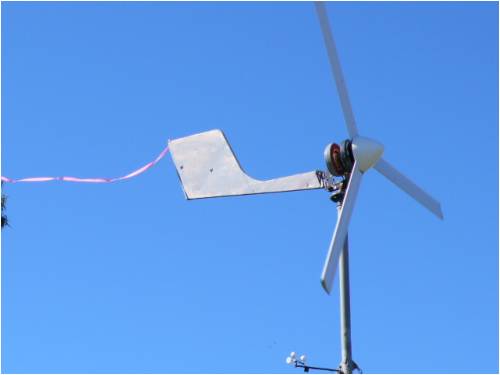

Anyway I give these the big tic of approval and I will be putting in an order for some more lengths for the AxFx , I've taken a heap of pics they should tell the story..

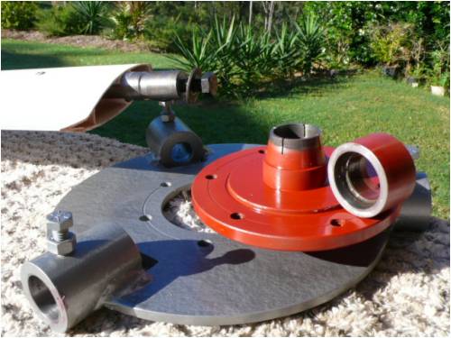

The Hub , collets onto the shaft as it compresses against the front rotor..

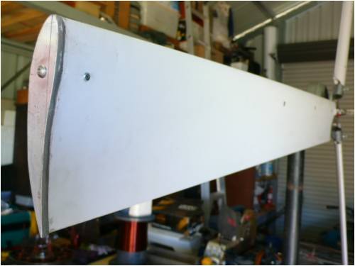

I made my own blade tips from 6mm aluminum plate , this made it easy when balancing , after the initial tube balance and run-out set up it did not require much more attention when the extrusions where rivited on..

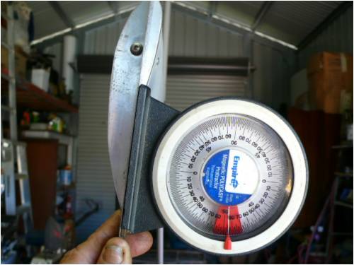

Setting angle of attack is easy with straight ends , they have been up to 350RPM today and don't seem to make excessive noise..
Blade Hub going onto shaft shows spacer tube used to compress the collet onto the shaft , this will be modified and the spline removed and a 14mm bolt taped into the 25mm shaft end will secure it better and make the front more compact..
The next blade hub will have the plate almost against the rotor keeping the rotating mass close to the frt bearing..

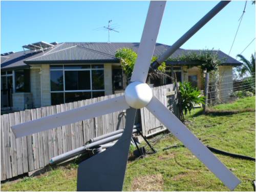

Nose Cone on
All up a pretty neat looking set of blades
Up and Running

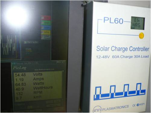

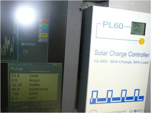

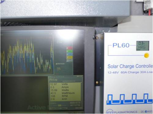

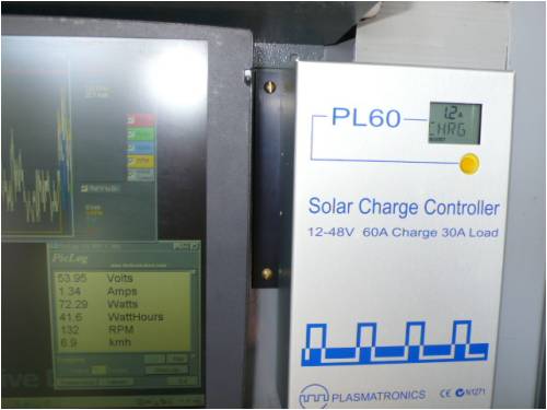

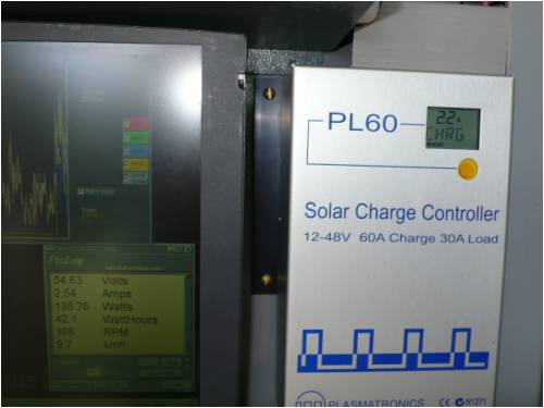

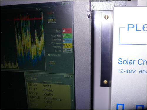

I've taken a few shots of the Piclog readout below , the readings should say it all , Please note this dual is set up in a 7p2s config with twisted poles and the voltage doublers and Caps to both stators @ 48v

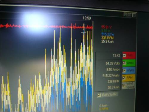

Just a quick update on the performance at the higher wind ,the piclog recorded this ( see pic ) , Its 7.30 at night and the mill has not stopped even in the night breeze of 2-8klm and still making little bits of power , as I said "UNBELIEVABLE" and looking pretty good for the top end..All up over 300w/hrs for the day and most of the day was below 14klm...

Posted: 01:01pm 19 Apr 2009
Is that 515 watts I see there?

Yep thats 515w but thats pretty well the norm for that wind speed , but the best thing was there was virtually no noise...
Woke up this morning to see 125W/hrs logged , the mill ran all night in 2-9klm , we have a good S/W blowing today so it is just cranking out the W/hrs , to coin a phrase here in QLD - I'M EXICITED - And that's what I think of these blades!!!!

Don't be green with envy , you just have to part with some of the green stuff and Im sure you will be happy with the performance , If I could have had these blades a year or so ago when I first started I would have saved so much time mucking arround with blades that really don't perform as they are not a good airfoil design , I would also be streets ahead in power produced.
The collet is like the way a die grinder or mill holds its tool a outer taper compresses an inner split taper onto a shaft .
As I said in my oriigional post I have come up with a design for a hub to suit these blades that will accurately mount the blades , at present I think it should be between $125 - $150 for the hub which will suit readily available tube.
To do a dual stator as a similar design as mine I would require a Shaft , F&P bearing housing ( with at least 10mm - 15mm of plastic still arround the aluminum housing ) and one rotor to be sent to me and I will do the mod and I should be able to do that for a similar cost. That will the give the person a compact dual stator with adjustable pitch and adjustable offset for tuning the blades and furling .

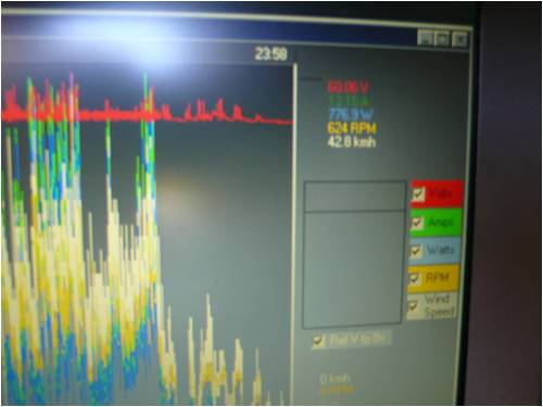

Had some good wind to give these blades a good test , took a couple of pics of the piclog readings
42 klm @ 624Rpm and outputing 770w , thats fairly hooting and says these blades can perform but I am finding they seem to be hard to set up with furling, but will keep that for " Furling - Getting it Right " thread
