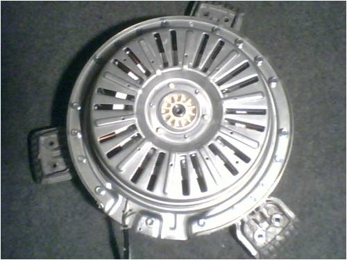

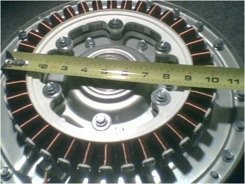

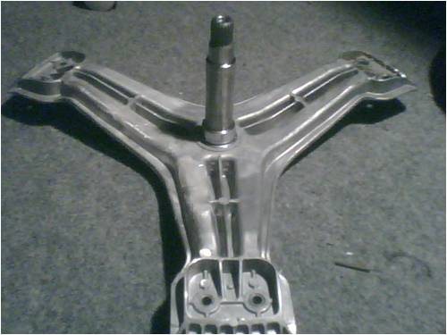

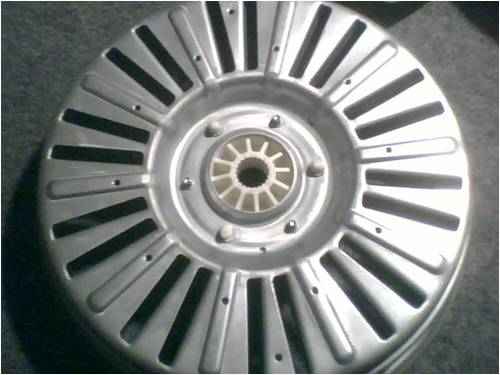

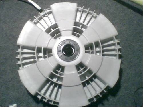

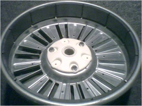

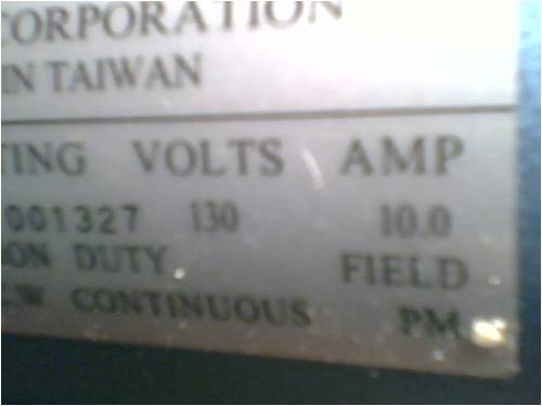

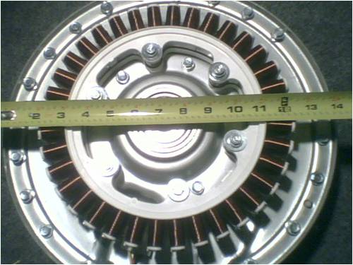

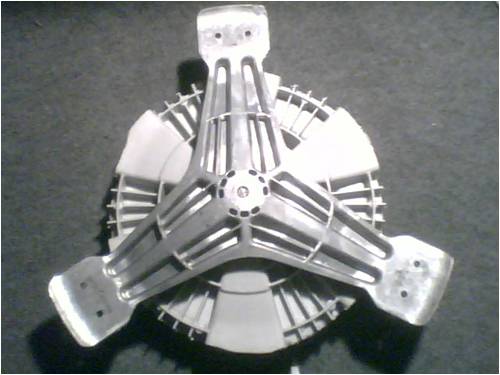

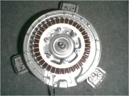

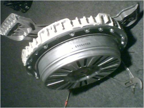

ok this the photos from the lg ..

I moved it by hand it powered up a 40 watt light bulb so i was wondering if their was a way to find out what is the max watts that this produces?
If you can find the ID Tag, Motor Data Plate Volts-Amps.
This will tell you what the wiring in the motor can handle without over heating. 120 VOLTS * Full load Current AMPS = Watts. There is Rectifier loss to charge batteries and Dc to Ac converter loss. Most people get about 170 watts in a good wind. Not worth the cost of a windmill and all the equipment.

I Just now saw your pictures and your post, If you do all the mods. you can upgrade the output , It'l cost ya.

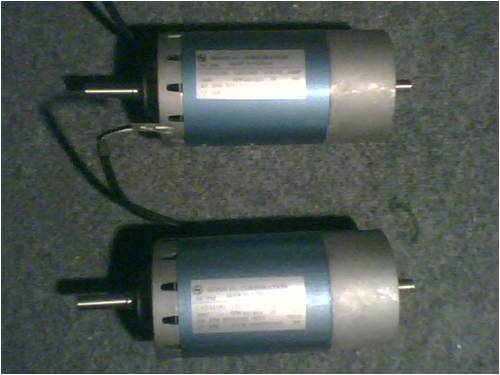

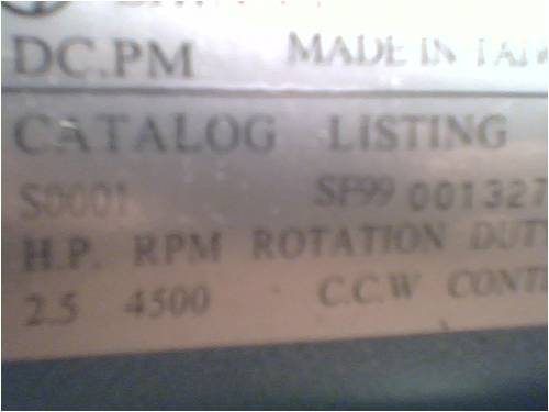

ok i bought these motors from ebay three weeks ago and i recieved it about a week ago they are 1400 watts 10 amps each and like i said before in the previous post i already ordered the propelar from ebay will this do the job if it does what type of power regulater will you recomend...thank you.

DTV004
Joined: 30/04/2009
Posts: 65
Posted: 06:17am 30 Apr 2009
ok do this one will do the job..
