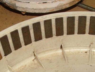

I found a pic of a 100, real chunky looking compared to a 80 or 60.

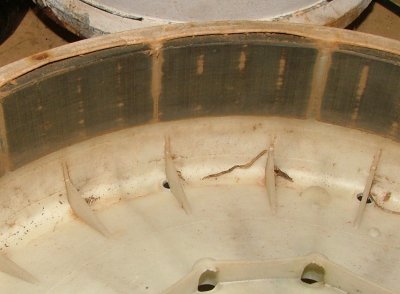

And these are the two hub types you will see. The 100's hub had individual magnets. The 100's are very rare these days, they were only used on the early models.
F&P later changed the hubs to these wider magnets. Each of these magnets is actually made up of 4 magnets side by side, you can just see some faint lines across the magnet where the poles meet and have attracted metal filings. I believe they did it to reduce the whine noise made by the washing machines on spin cycle, but I could be wrong, may have been cheaper this way.
