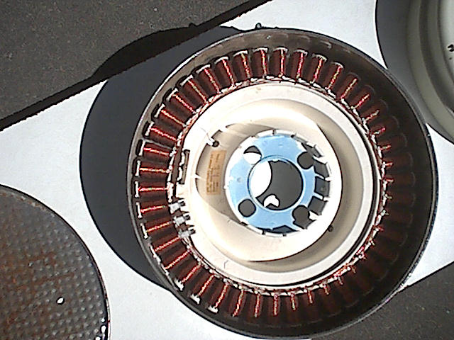

I'm planning something similar and also toying with the idea of using a metal rotor, the F&P stators are excellent but the standard rotors are average and inhibits potential, bellow is a pic of an old flimsy cake tin though I'm think I can get new thicker ones from department stores maybe these might work, anyone got other ideas?

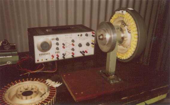

We played around with using the F&P as a motor to drive a solar car about 6 years ago. This is our test rig, with a standard hub.
The stator on test was rewound with 4mm wire ( yellow insulation ). To increase the output power we had a new hub cast from aluminium.

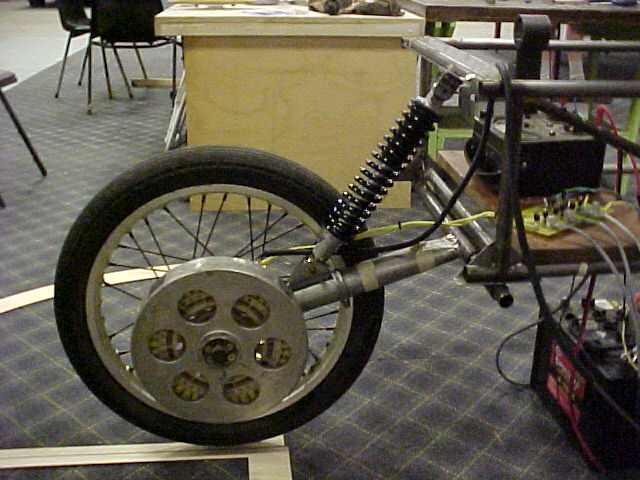

And on the car. The motor had great potential, but we gave up after a few months, had too many problems with the drive circuit, kept popping power mosfets. Ended up using a DC motor and drive chain.
