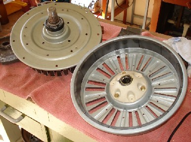

Posted: 04:25am 05 Nov 2009
A pic of the larger size rotor and stator
Bruce

Hey Bruce
Its a neat looking unit, hopefuly we will start to see more of these popping up.
I would try caps instead of Neo magents, caps a cheaper and a lot easier to use.
Do you still have that test jig Bruce?

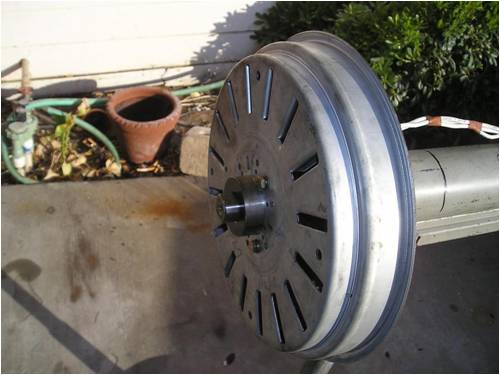

I knock out the center plastic and took a sproket and machine down hub to fit rotor hole and drill /tap for bolts to go into sproket
