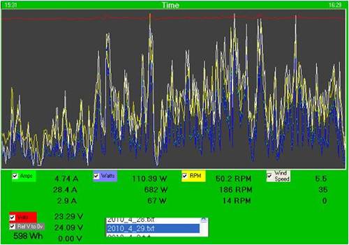

Posted: 12:15pm 30 Apr 2010
I went from almost zero wind to gal winds for this area,
so i got to see what my 2 stator wired in wyes could do.
amps are calibrated with a 100 amp meter , rpm is a 100 pulse encoder and it was calibrated on my lathe from 70 to 1700 rpms, the wind encoder is 100 pulse but i have not calibrated it yet but it close.
24 volt system
4.74 amps , 110 watts , 50 rpms , 5.5 mph , 2.5 m/s
28.4 amps , 682 watts , 186 rpms , 35 mph , 16 m/s
i think my blades are starting to stall at around 20 mph 9 m/s
and i see it furl at 25 mph 11.5 m/s
Edited by windman1000 2010-05-01

Posted: 01:45pm 03 May 2010
i took my wind indicator and mounted it on my truck , with a spare piclog and laptop and drove it around to calibrate wind, i was way off from what you see above here.
i had it set at 20 pulses but ended up with a setting of 30 pulses.
final readings
at 5 mph it read 4.9 mph ,at 10 mph it read 10.2 ,at 15 mph it read 15 mph,at 20 mph it read 20.3 mph,at 25 mph it read 25.5 mph,at 30 mph it read 30 mph.
so i think it was reading 8-10 mph to high before.
