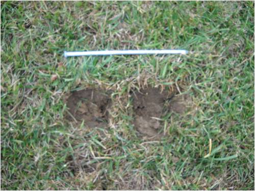

I started off by choosing a place in the yard and removing two 4" squares
of lawn (to be replaced after the posts are set). That pin lying there is
eventually going to hold things together and the pole-holding holes
must be no farther apart than the length of the pin.

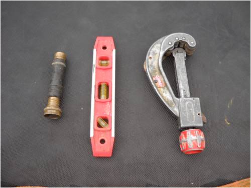

These are the only "special" tools I used. The thing on the left is what
I call a "water weenie". It expands inside a pipe, holding itself stuck
when the water is turned on while at the same time squirts out a small
stream inside the pipe. It was designed to "blow" out a clog in a drain
pipe and is often called a "blow bag". The other two tools are a spirit
level and a fancy plastic-pipe cutter (I'm a plumber by the way).

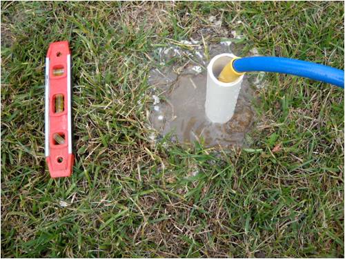

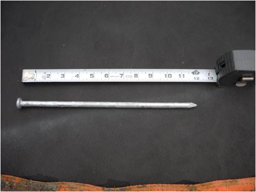

This has got to be the world's largest nail. I got it at Home Depot for
about $.59. It's galvanized steel and will become one of two pins.
We start embedding one of two 18-inch pvc pipes (which are just
slightly larger than the metal posts that will support the tower) by
inserting the water weenie, turning on the water and baby sitting
while the water digs our hole, constantly pushing down and twisting
while maintaining a left-right & fore-aft vertical position of the pipe.
See, I told you it would work! Beats heck out of digging holes and
pouring in fence-post concrete, then waiting for it to hydrate (dry).
I did it twice making sure the second hole and holder were no wider
than the pin I am using to keep things together. It's just a patience
thing; not at all difficult, really.

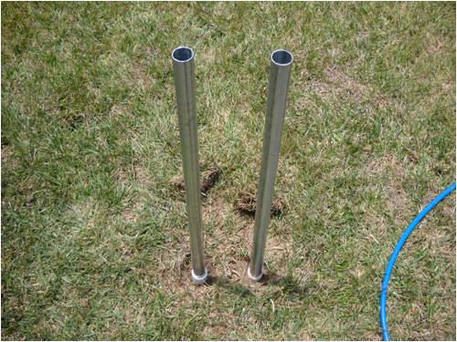

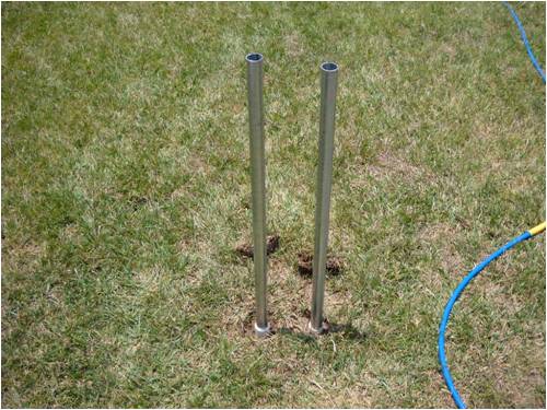

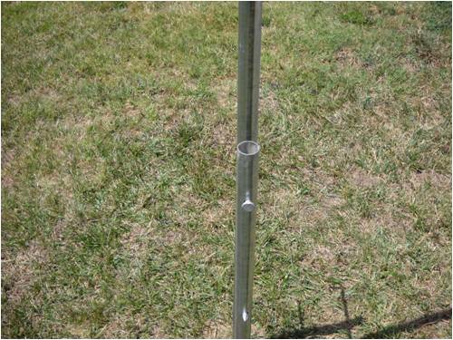

Here's a closer shot of both metal posts stuffed inside each of two
pvc guides we jammed into the ground using water to do all the
work.

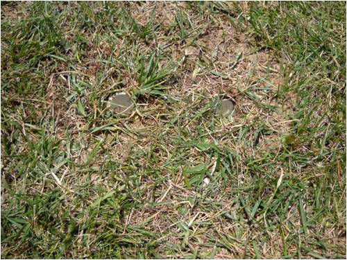

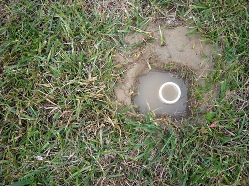

I used the sharp end of the metal pipe to remove a plug from each
of the two clumps of lawn I took out in the first step. Now it's almost
invisible; nobody but little ol' me and 13,000 forum members know
the post holders are buried there. Pretty cool, eh?

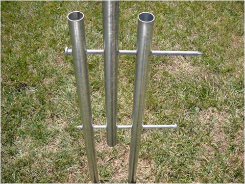

Next, after measuring where I wanted the pins to intersect both the
tower and the holder posts, I drilled all the holes. As easy as that
sounds, it took a couple of tries and several "blue" words to get 'er
done. It's always the "easy" part that stumps me.

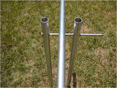

Here it is bare bones with just a few remaining parts to be built and
installed.
I took this shot from one side to show that by having just a little bit
of patience, you can get things to line up straight.

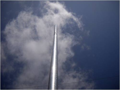

Here's a shot from the ground looking up at the top of the tower as
it is held securely by the holder. Yes, the top of the tower is all the
way up into that cloud!

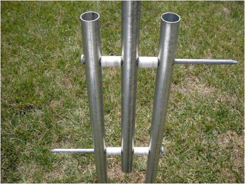

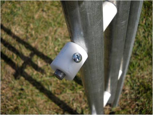

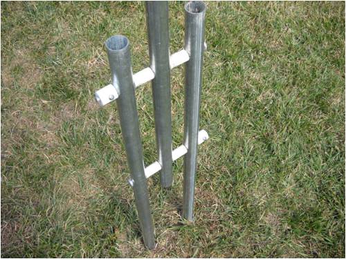

This shows 4 small chunks of 1/2" pvc sprinkler pipe (schedule 40 -
the thick stuff) being used as stand-offs. They hold everything in
the right place should this thing develop a mind of its own and want
to wander off somewhere. It's important that the holder actually hold
things taught as well as exactly vertical.
I fabricated two little "stops" one for each end of each pin. This lets
me cut off the remaining steel "nail" left over and lessens the chance
of someone (me!) snagging their britches on it.
Here's a shot of everything done and holding the tower. All that's left
to do is manufacture a bushing to be fitted into the top of the metal
tower's central spire and then the "mill" can be set in place. If things
get out of hand (weather) or I just want to work on the mill, all I have
to do is pull the bottom pin and the tower and mill both swing to the
ground as I control their descent.

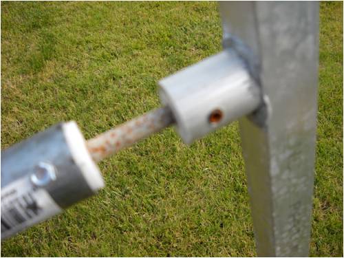

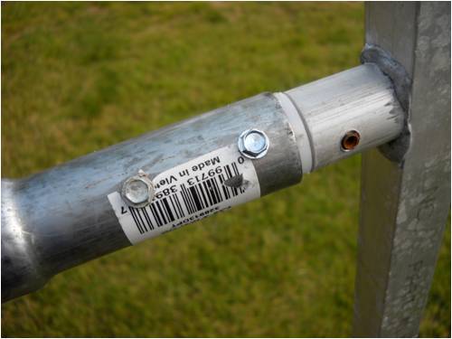

Here's a shot of that bushing. I pinned it in place with two set screws.
Recognize the windmimll? It's the skeletal remains of my backyard
toy, which threw a blade yesterday!
I snapped this shot merely to show the steel shaft, which extends
down the inside of the central tower riding inside the Delrin bushing
I carved out on my lathe.

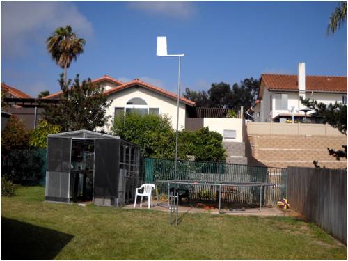

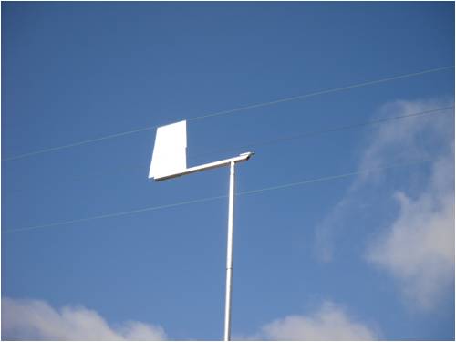

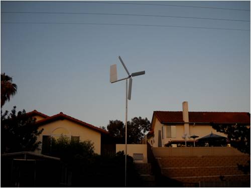

Here it is flying; largest weather vane on my block!
For perspective, this is exactly why I need to have a way to easily and
swiftly lower things out of (the neighbor's) view. You gotta know they're
gonna love watching my genny scream in the ocean breeze, eh?
