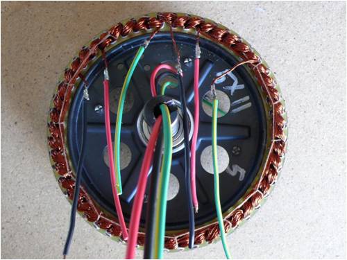

I then pulled it apart and found the star point and reconfigured it into delta , put some 2.5mm wire to the stator instead of the piddley 1.5 and wacked it back in the lathe . The difference was a eye opener for 12v and 24v especially . Torque was almost 1/2 at the same output in 12v @ 350rpm @ 550w with a lot higher cut-in, but in 24v for a lower torque @ 550 Rpm it was punching out 1065W and my lathe motor could not go to the next level .
Pic of Modified stator , drilling has to be enlarged a bit to fit 3 x 2.5mm
However the draw back is the high cut-in Rpms of 330 in 24V, which makes it an ideal canidate for the Cap/dblr to take care of the low wind power

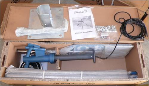

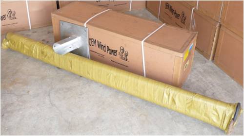

Kit and the tower in packing .

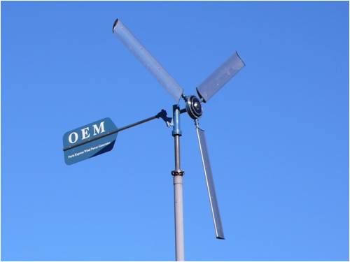

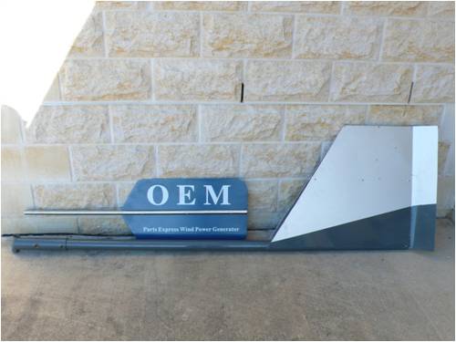

This is the origional tail size against the tail I put on the F&P Duals .

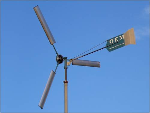

This One I have now done all the Mods to .

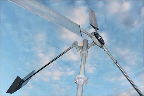

The Pic below is one that Forum member Amac has purchased, I have done all the mods to it and is on the way to him at present, he lives in a high wind zone and is setting up logging as well , he will be doing his own thread on how it all goes .

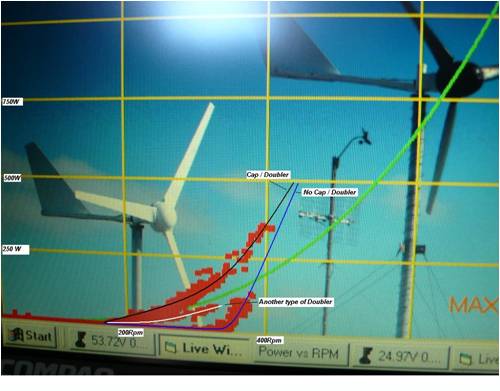

This Pic shows the difference a Cap/Doubler makes on " Gordons Windmill Analyzer" , this is a great tool to use when comparing changes to performance .
With all the changes it is now producing good power in low wind , all the readings in the pic above are in wind below 15-20 klm and it starts producing in under 10 klm .
