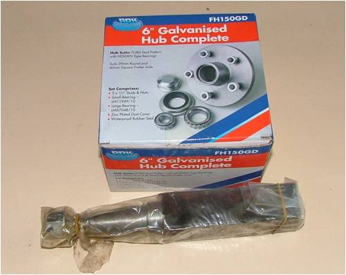

Well after a conversation with one of the long time forum members, I've decided to get my act together and start work on the Axial Flux windmill I mentioned in a previous post.
The big hold up has been location, I'm still living in a rental till my place is sold and very limited in what I can do. But Trev is going to help out with a location for testing, and his fiberglass skills in making the stator.
This is the new windmill so far, impressive isn't it.

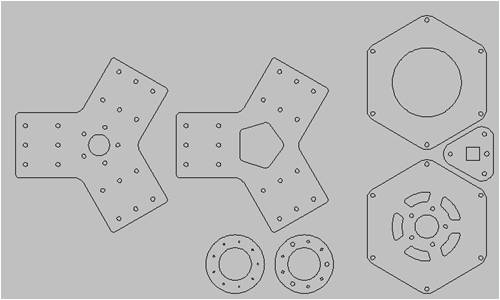

OK ok, not much to look at yet. Now that I have the hub I can finish the design work on the PC and get the magnet plates and stator supports lasercut. Its going to be a 24 magnet 9 coil axial, magnet spacings and coil winding based on the Other Power and Hugh Piggott designs, but using a different construction.
While a wheel bearing is not the most energy efficient bearing I could use, it is by far the easiest. The turbine will be 4 meters in diameter, and the blades built using Oz's chain saw technique. This will be the prototype, to iron out all the bugs. We'll then build a second and put the plans on paper ( the web site ).

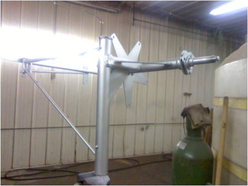

Based on information from a couple other 4m members, I've decided to use a shaft on bearings separated by several inches instead of the Timpkin tapered roller bearings used in automobile hubs. "My" reasoning is different from most, as I build only small stuff and the internal friction of a tapered roller bearing (especially a new one with no run-in time) is too great for my small blades.
Chris Olson has said he doesn't use the hub bearings either, because they are too difficult to adjust, especially when they're 80 feet up in the air.
Another reason for my choice is I have gone to using multiple rotors in an attempt to garner more current from a small-diameter alternator. I don't know how much weight you can cantelever on a single tapered bearing before it starts to wear excessively, but adding more rotors would do just that. My small toys have sealed ball bearings at each end and can support any load I throw at them.
Just some stuff to think about while you're in the planning stages.

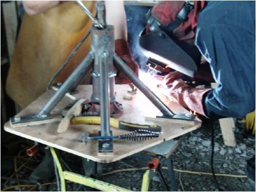

the bearing in here is out of something big and ugly from a nearby agricultural scrapyard .. it cost 20 euros (about 28 Aus dollars)..the whole machine is built around it
the bearings and shells were replaced before the mills final assembly ..
i think (...and its just a thought.) with thrust bearings like this, running with as big an air gap as the mill is comfortable with is the balance ...air gap (including play tolerance due to wear and tear ) seems the deciding (..builders choice..) factor
ps...the welder in the pic is called Sean... very nice welder too Edited by niall1 2010-07-29

I've finished the cad for the steel magnet plates, stator supports and blade mounts. I'll send these off to get a couple of quotes from the local laser and waterjet cutters. I also need to cad up the mould, and get that cut from MDF. All these bits could be cut by hand, but I'm lazy. Besides, its a new design and there are bound to be little changes needed along the way, so I'm going to make it as easy as I can for myself.
Magnet PCD is 270mm. I wont go into what the individual bits are.

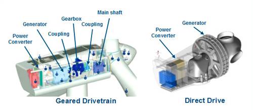

True but they are starting to design big turbines like that. Recent trends in the industry are leaning towards direct drive PMA turbines. They actually have a 'truck looking' spindle the size of a Volkswagen that the generator hangs off the front of.
It's funny because I always thought small wind would start to emulate big wind. I see more of the opposite happening.

Some are permanent magnet, but they're incredibly expensive to build. Enercon in Germany has long favored wound-rotor generator technology in their direct-drive designs, although permanent magnet technology is now the choice of most manufacturers of direct drive units under 90 kW.
A direct drive generator, with a wound field rotor is more complex, requiring excitation power to be passed to the rotor, but it benefits from additional controllability that you don't get with PM rotors. Without that controllability it requires expensive (and usually inefficient) onboard converters to sync the machine with the grid.

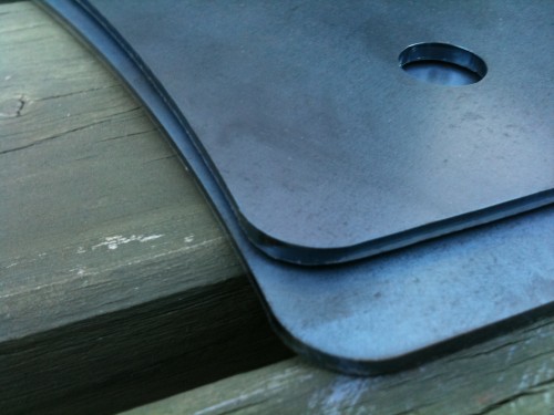

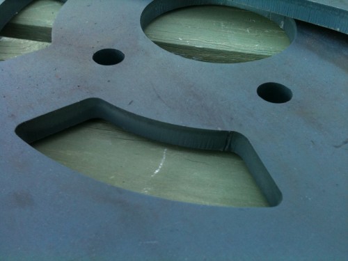

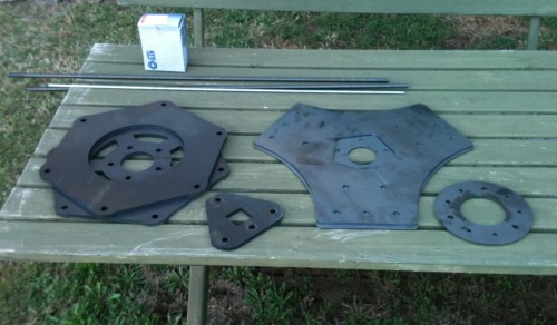

The laser cutter (http://www.lrsmky.com.au/) phoned to say my parts were ready, so I dropped round to pick them up this afternoon. While I was out I bought some 12mm and 5/16 threaded rod. I picked 12mm (M12) over 1/2 inch because it has a higher thread count, so should make jacking the plates apart easier. If I find the 12mm it just to small a thread, I can drill out the holes to take a 16mm thread, there's enough clearance in the design.
I'm pretty happy with the cut quality. This is the 10mm
and 3mm

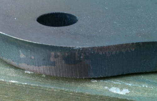

Below is a close up of the 10mm edge. You'll see a thin layer of dark scale flaking off to show the clean steel underneath. Whenever you get steel lasercut, hit the edges with a wire brush to remove this scale. If you dont, and you paint the edge, the scale will eventually fall off, with paint, to expose bare metal that will rust. Also worth noting, the laser cut edge is hardened steel, if you intend to tap a thread into a laser cut hole, its better to laser cut a smaller hole, then drill it to suit the tap. That way you remove the hardened layer and wont wear out your thread tap.
Next step is a trial assembly.
