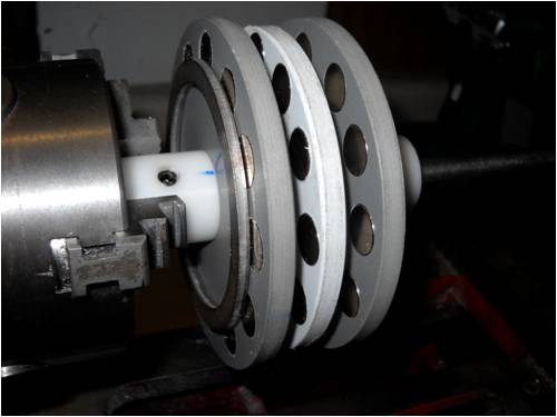

FYI, this (two magnet rotors) is the 'standard' build. If you want to up it even more, you can place a additional set of magnets between the existing two plates, allowing each of their faces to see the opposite face on the wheel magnets. I've done this and I have a picture so you can see what I mean:
Doing this allows the intermediate magnets to force the magnetic flux lines to travel in a straight line while providing a 'return-circuit' for the flux at the same time. I'm not sure if when doing this trick the air gap is figured in the same way, but it's likely the same. When I did it, I used the same air gap as I would have used for just two wheels.
The magnets in the center wheel are press-fit and glued into a HDPE (high density poly ester) wheel I cut out from a flat sheet using the faceplate on my little lathe. Now that I look more closely at the picture, maybe I used foam-filled PVC; I dunno!
Hope this helps.
