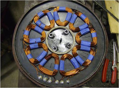

Glenn is correct. Your generator layout should look similar to this unit that I just built over the weekend:
That generator is wound with 12 AWG - don't even attempt it unless you have a conduit bender to make coils with.
If you build with large gaps between the coils the generator will "buzz" and vibrate and you'll have stator bolts coming loose all the time and several other problems. This is due the loading/unloading of the generator pole as it wipes a coil leg, then "lets go" and travels across a gap doing absolutely nothing except going for a ride on the merry-go-round until it gets loaded again when it finally gets to another coil leg.
The rule of thumb that I use is no more than half the width of the magnet as gap between the coils. However, even at half the width of the pole, the generator will still vibrate bad enough. The generator in the photo was installed on the turbine last night and ran all day in a 20-25 mph breeze on a 10 foot machine and it runs so smooth at 1 kW that all you can hear is a steady hum in the tower. I've run generators with wide spacings between the coils and they buzz enough to cause sufficient vibration in the tower to take the bearings out of your anemometer.
The other thing that's important in an axial is having the coil leg perpendicular to the path of the magnet, hence the wedge design coils in the photo. To get optimum efficiency adjacent and opposite generator poles should wipe both coil legs at precisely the same time. You can't just arbitrarily make up coil shapes and dimensions and get an axial to work.
Those 12 AWG coils were such a bitch to get right that I still ended up with a slight bow in the coil legs, even after clamping the coil between two wood blocks and beating the snot out of the coil leg with a rubber hammer to straighten it. But it's close enough because it runs pretty darned smooth.

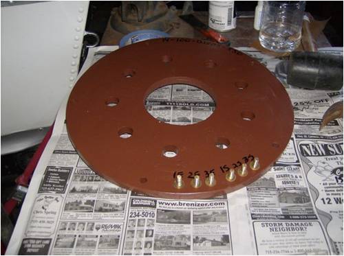

This is what that stator looked like after casting and ready to bolt on the turbine. I cast it yesterday morning and bolted it on the turbine about 8:00 last night. This is a 24 volt unit, 50 turns of 12 AWG, N50 2x1x.5 bar mags on 10" generator rotors for a 10 foot machine. It put out 44.61 amps @ 28 volts today, peak on the Doc Wattson, and ran at 30-35 amps most of the day.
