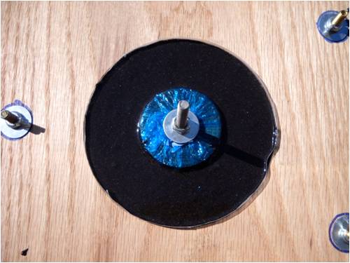

Here are a couple of pictures of my latest endeavor. I'm building a magnetite-filled solid stator ring, which will be machined (once I figure out all this casting business) to hold coil windings much the same as an F&P does with laminates. Magnetite has no hysteresis and is free (magnetic beach sand); the perfect match.
This shows the stator core already popped out of the mold. The plastic
wrap sticks to the resin (I used polyester resin here), but it peels off
without difficulty.
The first rotor I made got stuck in the mold, so I came up with a better "release" agent -- plastic wrap. That first rotor didn't have enough catalyst in it and took about 2 days to harden up. This latest one went off in about 20 minutes; I doubled the catalyst amount. It's a learning curve!
I still have to pay more attention to the area where the plastic tucks up
against the corners and edges of the mold.
As you can see, I missed it a bit on this one; again -- learning curve. This iron-filled donut gets machined, but unfortunately the inside (where I boogered it up) is already nearly to size and has to pop out of the mold not needing machining.
I think on future castings, I'll smear Vaseline petroleum jelly on things before I flop in the plastic wrap. That way, I can use a sponge or Q-tip to get the corners and edges tight before I pour in the resin. Sooner or later, I'll throw up a post showing the whole process, but I thought I'd share now what I've learned so far.

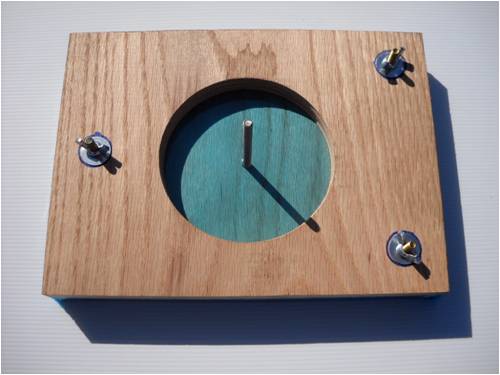

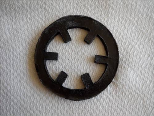

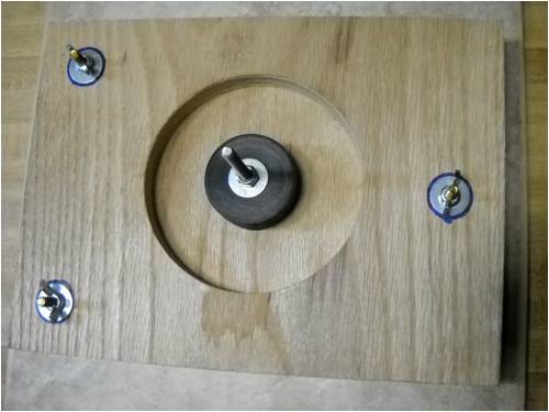

I figured out a way to make the corners square. I manufactured a 3-piece mold out of red oak that clamps together.
Here's the contraption from the top:
I used three 1/4-20 "Closet Bolts" (these usually hold down toilets), which
both align and lock the halves together. The center cylinder, which
becomes the inside of the stator is a bit smaller than I need, to allow
for slight machining to make a close "air gap" between stator and rotor.

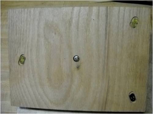

Here's the bottom side:
I counter-sunk all the bolt ends so the rig sits flat on the table while
the resin mixture goes off.

I made a new mold and now have a new stator that looks very promising. I'll run through the steps here in case there's anyone else wishing to travel this path:

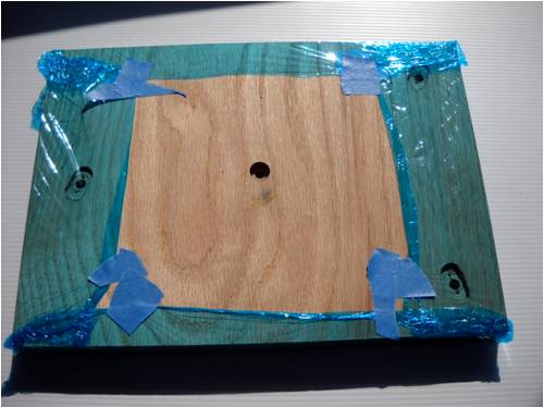

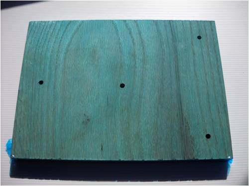

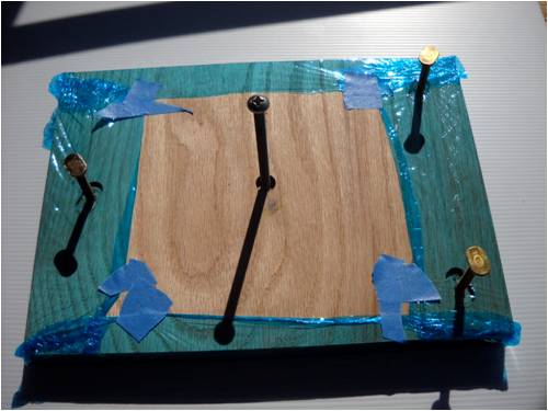

First off, I covered the face of the red oak wood mold with blue plastic
sandwich wrap and taped it to the back, smoothing out the wrinkles:

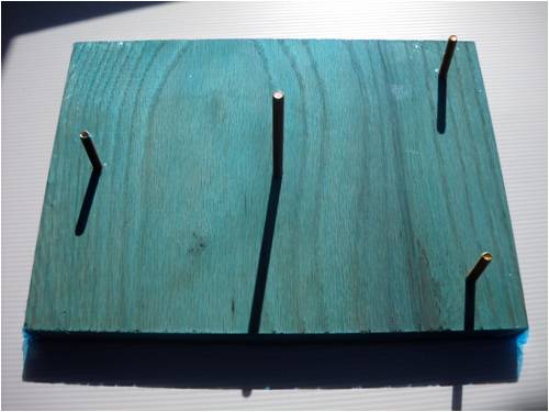

Here's that back side. I used blue film and blue tape so folks could
see things better. You can use any color or no color.
From the back side, I then jammed all the bolts that clamp the thing
together through their respective holes.
This is what they look like as they come poking through the top side.
Next, I fitted the top half of the mold over the pegs and cinched all
the wing nuts tight.

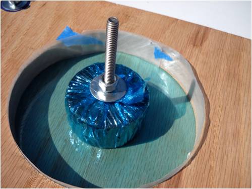

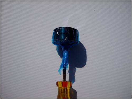

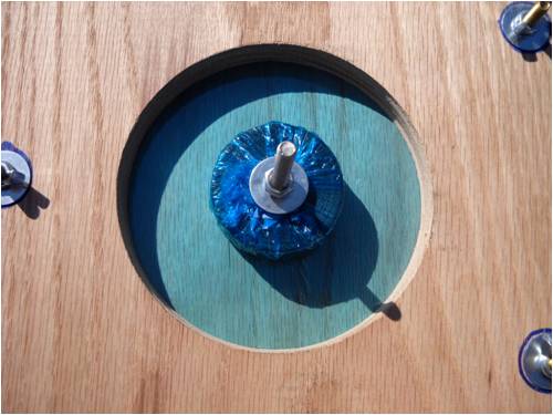

I then wrapped the center spindle with film and taped it closed at the
top after getting as many of the wrinkles out first. I think I'll use wax
paper on future builds as the film is too thin and it was hard to remove
the plug after the resin cured.
The center plug was then slid down over its hold-down post and the
nut was tightened over a washer to make things good & tight. That
reminds me of a joke: What is the German word for virgin?
Gootundtight!

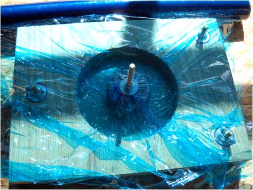

Next, I draped another sheet of sandwich film over everything and
tucked it into the corners with a Q-tip and pencil eraser. This is to
allow me to pour in magnetite powder until it's full, so I have enough
and the casting doesn't come up short.

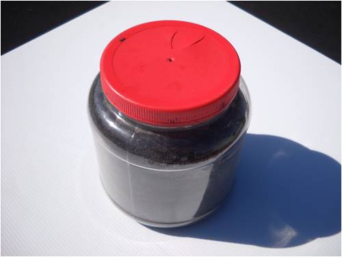

This is my jar of magnetite. It's a plastic quart jar intended for peanuts,
but I use it for magnetite. It weighs in at around 35 pounds when
full. Even though this stuff is "free" at the beach, it took me about 10
hours of trapping and refining to get it pure enough to use in a stator.

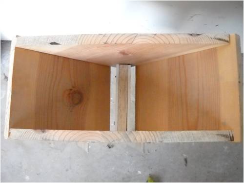

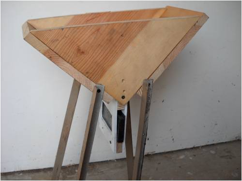

I built a contraption that holds a large ceramic magnet under a stream
of sand that pours down through two slots of an 8" x 16" wood funnel
into which I pour dry beach sand. The thing stands on 4 little adjustable
legs.
Here's a picture of it from the side. That big square black thing is a
flat ceramic magnet that catches magnetic sand on each side as it
pours past, mixed with the blond sand.
Here's a view from the top. The "funnel" is divided into two halves,
separated by the magnet hanging at the apex (bottom). As the sand
makes its way by gravity to the opening, half falls on one face of the
magnet, while the other half falls past the magnet's opposite side.
The magnetite has no hysteresis, so it sticks equally well to either side.
When you shove it from a north face to a south face, it doesn't care.

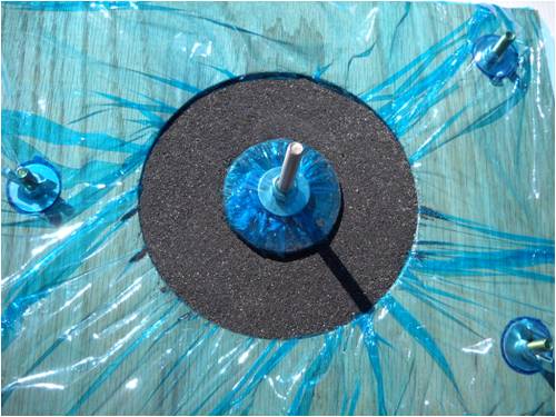

Here's a shot of that over-laid sheet of film holding enough dry
magnetite to fill the space.

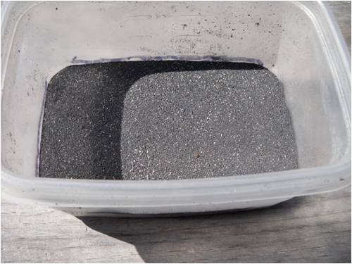

The pre-measured amount of magnetite was then poured into a small
plastic mixing container. If you look closely, you'll see where I've marked
the outside of the container at the top level of the magnetite. Next time
I build a stator, all I have to do is fill the container to the line and I can
forego the over-laid film step.

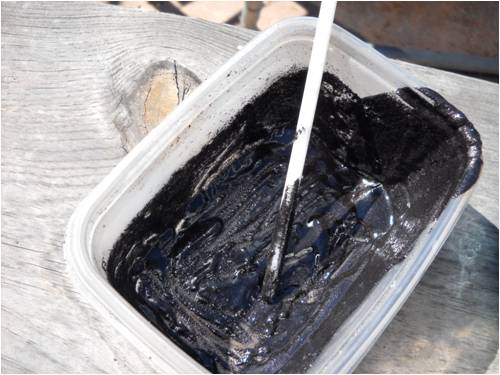

I added enough liquid polyester sanding resin to make the mixture the
consistency of brownie mix, then added more until it was like cake mix,
then a little bit more to make it barely "runny". I then added 26 drops
of catalyst. I was going only for 25, but an extra one dropped in at
the last second. I didn't take any pictures of the mixing phase, cause
I didn't want to take time, fearing the mixture might decide to "go off"
before I was ready. So, anyway, this is a picture of the mixing cup and
plastic stir rod after I had poured the mix into the mold:

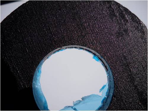

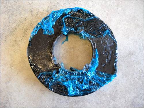

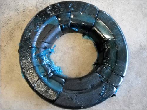

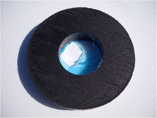

After about a 3-4 hour cure in the sunlight, here's what popped out.
I should explain that in actuality, it didn't exactly "pop" out. Next time
I'm doubling up on the wax paper and lining the center plug with two
layers of wax paper too. This time I had to bang on my creation to
get it out of the mold. Kinda like spanking the hell out of a newborn!
Notice the crisp, clean, straight right-angle sides. This is exactly
what I was after. That inside hole is a bit too small for my magnets,
which allows me room to zero in on it with my lathe. By cutting this
to its final size, I can assure the smallest air gap possible.

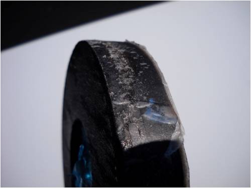

Here's a tight shot of the outside edge. That wax paper will peel right
off. The outside doesn't matter much except maybe for looks. It's the
inside where it matters. I'll wait until tomorrow before I machine in
the wire lands, allowing things to cure for another day. It smells pretty
strongly of polyester resin still and may be soft in the middle (like me!).

Edit: I added a couple pictures of the magnetic-sand gathering tool I built.

Future pours will see two layers of wax paper around this thing, which should allow both enough room for expansion (if any) as well as a small interface between the wax paper layers. That should afford me enough slippage to get it apart more easily. I purposely made the center spindle smaller than the final inside diameter so I could machine it to fit the magnet rotor.
As for molding in all the little notches where the windings will go, I thought it easier to use a fortner bit and cut them on the drill press after first having marked their position off a drawing I constructed with my compass (second favorite tool I own) after dividing a circle into 9 equal parts.
In case anyone is wondering how I did that, it's easy. 360* divided by 9 equals 40*. Someone more clever than I took the sin of half that and came up with .342 and I multiplied the diameter of my core (on a paper drawing) by .342 to get the length of one side.
Next, I used my digital calipers and set them to the answer, which in my case was 1.92375 (rounded to 1.92) and set my compass to that reading.
Next I marked out lines along the outside edge of my stator's circle, placing the point of my compass on the drawing starting at an arbitrary point making 9 equally-spaced lines crossing the circumference and then drew a line from each of those points to the center. Bingo! Nine equally-spaced lines to center.
I marked the distance from the center of the fortner bit to intersect the correct position on one line, then spun a circle on the plan using that point and the center to make a circle intersecting all the other lines and thus marking each drill center position so I get all the holes in the core at the correct position. Easy, really.
So, the next step will be to drill out all 9 places where windings will go leaving 9 little open spaces and creating an actual stator. I'm using 9 coils and swinging 6 magnets, hoping the odd combination will offset it cogging somewhat. If it cogs, I'll just add two more cores and offset them from the first, then run three individually-rectified circuits down the pole.
. . . . . Mac
Copeville, Texas

I've made a few changes to things. I figured out a way to make the center "plug" mold out of rubber mat, so when things cure, all I have to do is pull it away from the edges. Being flexible, it just comes out of the mold making the mold ready for a new pour.
Future molds will be constructed from all-rubber sheets laminated together. There will be one mold for the outside and another for the inside. The two halves will fit together. Magnetite-filled resin will be poured in between the two molds, so when things go off, the two mold pieces will simply get peeled away from the finished product.
Make any sense?
I've heard it said a picture's worth a thousand words:
Ta-da! This is the latest to pop out of the mold. The little spokes
will get wrapped with enameled copper wire and become coils, which
the magnets will whir past. Future cores will be made so there is a
dimple where I'll drill the mounting holes. Those holes will serve to
both hold the core to my lathe's face plate so I can machine the central
hole to the correct size, creating the thinest air gap possible, as well as
hold it to the actual windmill when it gets that far. Also, I've cut down the
coil count from nine to six in hopes to better-accommodate the 6 magnets
on the spinning central shaft. There will ultimately be three coil cores, each
off-set from the other by 1/18th of a circle, so as one set of magnets is
on top of its respective coils, another set is just arriving and yet another
is just leaving its coils. This is an attempt to counter the cogging effect.
