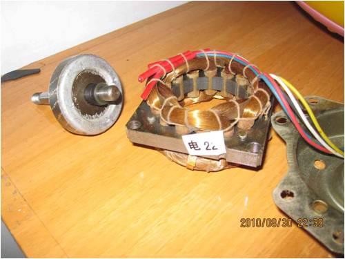

if you were to machine some strong neos into thatinductin core and put some solid metal in behind them instead of the squirrel cage tose coils should produce some usable power. make a slant core out of it and the cogging should be minimal. If you don't have access to a machine shop if your carefull and take your time with a mini grinder you can get the slots cut and epoxy them in. Get rid of the starting cap though, or use it somewhere else. Edited by itsandbits1 2010-10-07
